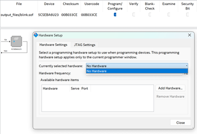

I am working with the DE10 Nano kit for my current project.
I have installed Quartus Prime Lite Edition (22.1std.0.915) inside Parallel Desktop 18 (Win 11) running on MacBook M1 (Ventura). I could compile the projects but faced issues deploying them to the FPGA.
The Hardware Setup does not detect the DE-SoC (USB-1) as indicated in how-to-program-your-first-fpga-device. The device Manager of Parallels-Win11 shows an unknown device with a yellow icon. It appeared that it was looking for USB Blaster-ii drivers. I have not been able to find suitable drivers for ARM64. I receive the prompt "Windows was unable to install your Unknown Device" for all the drivers I tried from the internet. The drivers present inside the quartus/drivers/usb-blaster-ii directory also have the same problem. I believe that all those drivers are possibly incompatible with the Win11+MacM1 system. It could well be OS & Driver problem than the Quartus problem.
Any proven workaround suggestions would be really appreciated.

it is stated quite clearly that they are using the DE10 Nano kit which is equipped with an on-board USB Blaster II.
They also state that a corresponding driver for the ARM64 platform is missing and that the supplied USB Blaster driver is incompatible and therefore refused by windows.
It would be welcomed by a large part of the community if Intel could commit to providing a compatible driver for ARM64 platforms.
