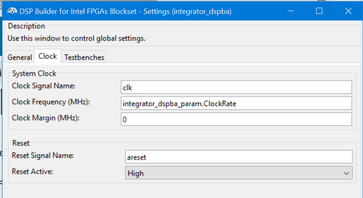

I am building a PI-controller for an FPGA with the Intel DSP Builder Advanced Blockset. Therefore, I use the forward/backward Euler approach.
I have not enough insights yet in the different clock frequencies and sampling times. What value is used for the sampling time T_s?
I suppose it is not the Clock Frequency in the FPGA. What is it else?
Is there any other possibility to implement an integrator with DSP Builder Blocksets?
Thank you for your support

T_s isn't a sampling time, it's a factor. Because the integrator input value is added to the integrator once per clock cycle, the factor is scaled with clock frequency.

Thank you. Yeah I understand that T_s is a factor. But is in my example T_s=1/integrator_dspa_param.ClockRate*1e-6? (1e-6 because the clockrate is in MHz)
I am confused because during simulation, it sometimes depends on the simulink step size

hardware-wise, time discrete integrator has clearly defined behaviour. 1/z is a single clock cycle delay, e.g. 1 us with 1 MHz clock. Question is if it's correctly modelled in your simulation? I would expect a fixed time step.
