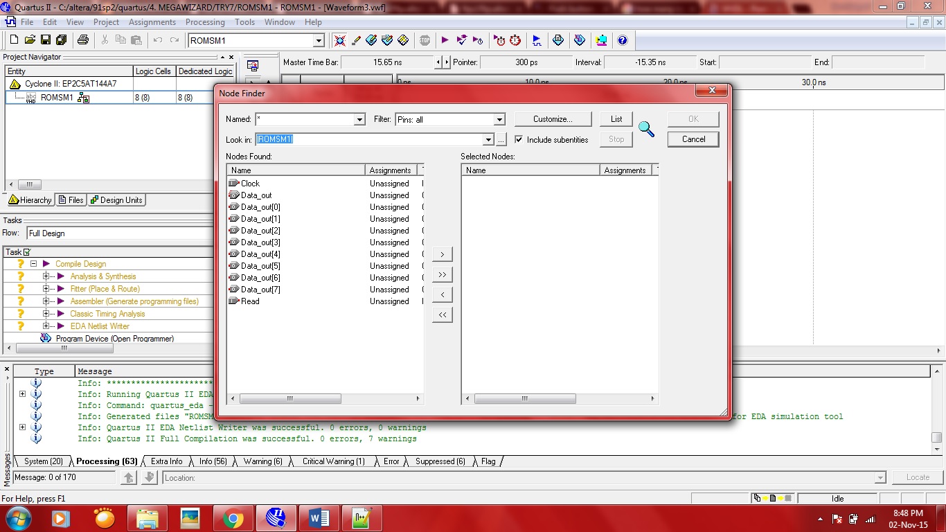

Hi guys.
I have problem with my coding now. I have design my vhdl code for ROM. The problem is when I want to see the waveform, the input port for "Address" cannot be find in node finder. Could somebody help me? Is it because many address in my ROM? Is there any limitation for address in ROM? Here is my coding.

Address : in std_logic_vector(1 downto 33);

Altera_Forum
518 Views
I would check your warnings.
declaring the address as 1 downto 33 means it is a NULL array and has 0 length. So I assume your ROM (and address input ) has been removed during compilation.
