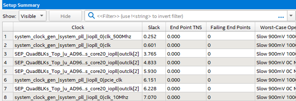

I'm using LVDS receiver (LVDS_RX) to process ADC serial output data stream. LVDS_RX provides one output parallel clock, rx_coreclock, which is used for asyncronous FIFO's write clock. The FIFO's read side uses system clock.
When above logic is implemented, the system clock domain's reset signal is used on rx_coreclock domain. After full compilation, I get Setup and Recovery timing violation report.
Setup Timing Violation Report:
Recovery Timing Violation Report:
After I found that the reset was used in two different clock domain, I synchronized this reset signal from system clock domain to rx_coreclock domain. I thought this should resolve above two violations. However, only Setup timing violation was resolved.
Resolved Setup Timing:
The Recovery Timing violation still there.
Report Timing from TimeQuest for the Recovery:
As above image, the Recovery timing violation's From Node coming from system clock domain's reset signal. And "To Node" comes from re_coreclock domain's reset re-synchronized module's two inner nodes. Below is the re-synchronized module codes:

So my question is how to resolve this recovery timing violation. Can i use set_false_path command to deal with it?

I tried to apply false path constrain in my project. According to above recovery timing violation report from TimeQuest, both lauch and latch clock are different clock. They are:
Launch Clock:
system_clock_gen_|system_pll_|iopll_0|clk
Latch Clock:
SEP_QuadBLKs_Top_|u_AD9633D_SDataProc|LVDS_RX_8Ch6B_inst|lvds_0|core|arch_inst|internal_pll.pll_inst|altera_lvds_core20_iopll|outclk[2]
So I thought to add following clock group constain to my project:
set_clock_groups -asynchronous -group {system_clock_gen_|system_pll_|iopll_0|clk} -group {SEP_QuadBLKs_Top_|u_AD9633D_SDataProc|LVDS_RX_8Ch6B_inst|lvds_0|core|arch_inst|internal_pll.pll_inst|altera_lvds_core20_iopll|outclk[2]}
However, after compilation, QPP23.4 gave me following warning info:
Ignored filter at my.sdc(21): SEP_QuadBLKs_Top_|u_AD9633D_SDataProc|LVDS_RX_8Ch6B_inst|lvds_0|core|arch_inst|internal_pll.pll_inst|altera_lvds_core20_iopll|outclk[2] could not be matched with a clock
Assignment set_clock_groups is accepted but has some problems at my.sdc(21): Argument -group with value SEP_QuadBLKs_Top_|u_AD9633D_SDataProc|LVDS_RX_8Ch6B_inst|lvds_0|core|arch_inst|internal_pll.pll_inst|altera_lvds_core20_iopll|outclk[2] could not match any element of the following types: ( clk )
Above warining infos tell me that Quaruts ignored above clock group constrain. Even above info gives the reason why it ignores the constrain. But I still don't know why? Quartus can't identify the LVDS PLL output clock as clock?
