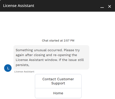

9,276 Views
I think I did. It has been a while.
I tried to verify but currently, License Assistance has been down for the last three days. See attachment
The new server was added to the list, and that's item 2. Then I generated license.
Thank You.
MGRazor
9,241 Views
NurAiman_M,
January 21. License Assistant still down.

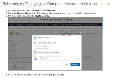

NurAiman_M_Intel
9,189 Views
NurAiman_M_Intel
9,189 Views
Have you try to rehost without License Assistant? As shown in the photo.
AIman
