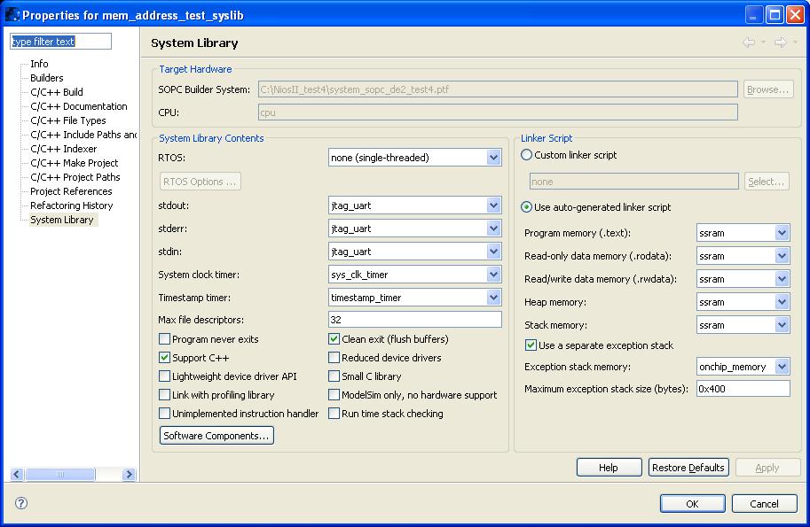

Do You see that You're writing to address, where Your Nios CPU firmware is palced? you're basically destroying the CPU itself. You are probably writing to the reset vector, so the CPU resets and SDRAM controller resets too.
--- Quote Start --- Do You see that You're writing to address, where Your Nios CPU firmware is palced? you're basically destroying the CPU itself. You are probably writing to the reset vector, so the CPU resets and SDRAM controller resets too. --- Quote End --- Hy Socrates.. You mean this reset vector??(attached*) I didn't write to that address, did I ? I write the data to SDRAM_BASE .. Please correct me if I am wrong .. Or maybe you can show me some example? Thank you in advance Yuyex:o
Oh, then it's ok. Where are .heap, .bss and other stuff placed?
