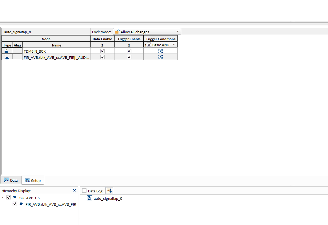

since I moved to Quartus 23.1, Signal tap is almost unusable. Each time I click on a button, a tab or when a capture is triggered, the checkboxes in the Hierarchy display pane become unchecked automatically and the signals disappear. I have to check them manually to see the signals again.
See the captures attached.
I tested with standalone Signal tap 22.1 and it has the same bug but 20.1 works fine.
I also see that the Intance manager bar is empty, I cannot start an acquisition.

This is a known issue with Quartus Standard and occurs specifically with the Windows OS. Currently, you may need to check it periodically to ensure that the setting remains as intended.
KDB link: https://www.intel.com/content/www/us/en/support/programmable/articles/000097912.html
We apologize for any inconvenience this may have caused.

I just point out that this bug not only occurs when the trigger occurs but also when almost any action is done in the Signal Tap window. This is very painfull and hope it is fixed soon.
