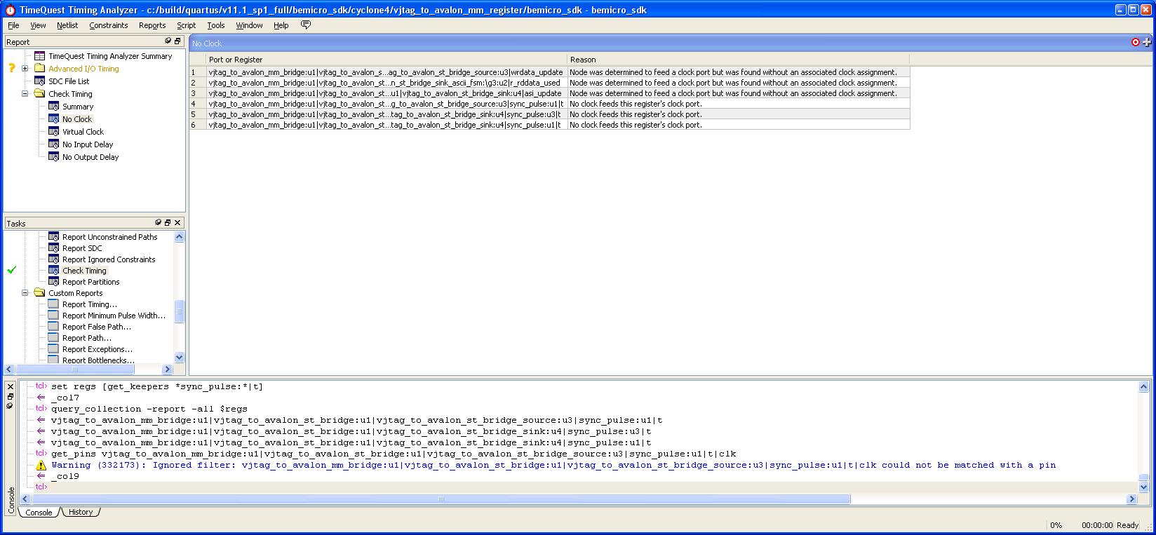

--- Quote Start --- It's |clk So, you'd want a constraint like set_false_path -from [get_pins t|clk] -to clk --- Quote End --- Does this syntax change when you have a hierarchy to the register though? Look at the timequest screenshot I've attached. It doesn't like the syntax for the register ending in t|clk, or t.clk, or t|.clk. --- Quote Start --- Not that it'll suppress the warning, though. --- Quote End --- But I think defining it as a clock and putting it in an exclusive clock domain would. I'd like to see if it does anyway :) Cheers, Dave
The paths in that screenshot are for register objects.
If instead of the register, you want one of those register's clock pin, then you just add |clk to the path I think adding a clock on the pin will suppress the warning.- Mark as New
--- Quote Start --- The paths in that screenshot are for register objects. If instead of the register, you want one of those register's clock pin, then you just add |clk to the path --- Quote End --- The syntax is still escaping me. In the screen shot in the last message I posted, I have used the syntax for register objects ... what then is the syntax I should be using to get the registers clock pin? I added |clk to the path and used get_pins, but TimeQuest does not match that name and returns an "Ignored filter" message (see the screenshot). Let me put this another way; in the screen shot, there are three signals identified as nodes feeding clock ports, and three registers without clocks attached to their clock ports. Based on the fact that I can search on the component name sync_pulse and identify the register ending in t, I should be able to work backwards and identify the signal feeding the clock port on that register, and then assign that signal as a clock. I'm basically looking for the Tcl procedure sequence to navigate the hierarchy in a generic manner, so that I can have a sync_pulse.sdc that will automatically find all the input signals to the sync_pulse, and define the signal as a clock. For example, given one of the registers in the screen shot, I should be able to navigate to one of the signals identified as a node feeding a clock port. Using create_clock on the three signals does clear the 'Check Timing' warnings, so I'm on the right track. Sorry for being dense :) Cheers, Dave

After some googling... there's an issue with a setting called "Display entity name for node name". Put simply: they (default) way get_node_info works for register names is not compatible with the filters get_pins accept. http://www.altera.com/support/examples/timequest/exm-tq-entity-instance-names.html set regs [get_registers *sync_pulse:*|t] foreach_in_collection reg $regs { set regName [get_node_info -name $reg] puts $regName regsub -all {\w*:} $regName {} regName puts $regName set clkPin [get_pins ${regName}|clk] # now you should be able to apply constraints based on $clkPin } I wouldn't call it abuse Quartus. But I would just live with the warnings; or suppress them. I don't like adding stuff I shouldn't just to suppress dumb warnings.- Mark as New
Hi rbugalho,
--- Quote Start --- After some googling... there's an issue with a setting called "Display entity name for node name". Put simply: they (default) way get_node_info works for register names is not compatible with the filters get_pins accept. http://www.altera.com/support/examples/timequest/exm-tq-entity-instance-names.html --- Quote End --- Thanks! I'd missed that page. --- Quote Start --- But I would just live with the warnings; or suppress them. I don't like adding stuff I shouldn't just to suppress dumb warnings. --- Quote End --- The objective was to suppress the warnings. I am simply using TimeQuest constraints to suppress them. I've attached the "Report Clocks" report for both method 1 (the first method I figured out) and method 2 (the method you pointed me to on the Altera site). Because method 2 strips the component names, the clock name in the "Targets" field of the report window becomes less verbose, but then that means the hierarchy to the synchronizer is a little less obvious. I don't see any particular advantage in one method over the other. As I commented earlier, I plan to replace this synchronizer with one that uses the JTAG and core clocks directly, and I won't introduce this extra synchronizer clock, so I won't be using these TimeQuest constraints any time soon. However, this was an interesting exercise in TimeQuest syntax :) Thanks! Cheers, Dave- Mark as New
