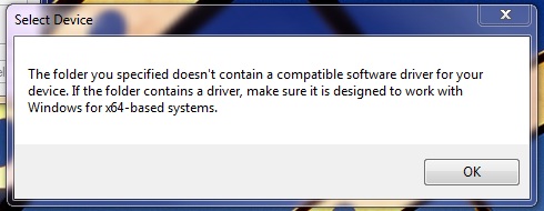

Hi there,
Same problem with Byteblaster... I have tryed Wasabi_rice's driver on Win7 64-bit and it did not work (see message in attachment). Does anyone have the old drivers (Quartus 7) that are supposed to work with Win7 64bit, having disabled driver sign check at boot time? If so, would you please share them on this forum? Thanks. Cheers, C. --- Quote Start --- Sup all, I am running win7 x64 here. Here is a modified USB blaster driver I came up with. It works 100% as I tested on several machines. Hopefully this helps. Cheers Howard --- Quote End ---- Als neu kennzeichnen

Hi there,
Perhaps it is to late for some people, but I eventually found the USB-blaster drivers from Quartus 7.1 that works under Windows 7 x64 (64-bit). Please find them in attachment. In order to install and use these drivers, as pointed out above, you need to press F8 while booting Windows 7 x64 and choose Disable Driver Signature Check. Then you can install the drivers using the Device Manager. Note that even once installed, you need to disable sign check every time you want to use you USB-blaster device. I hope it helps.- Als neu kennzeichnen
