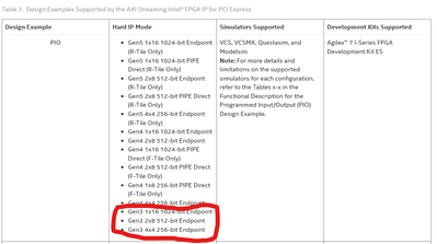

Hi ,
I try to run the example design in Gen 3 1x4, I am getting similar error as you.
BUT, this issue is not observed in Gen3 1x16.
There should be an error when generating/compile if it is not a supported ED.
If referring to AXI Streaming Intel® FPGA IP for PCI Express* User Guide under 3.4. About the AXI Streaming Intel® FPGA IP for PCI Express Design Examples
Obviously, Gen 3 1x4 is not in the option, hence the compilation fail is expected.
If your project requirement is not strict to gen3 1x4, I suggest you to consider other available option.
