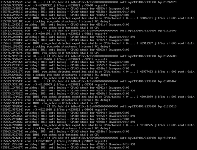

Greetings,
I am experiencing an issue with the use of QAT in conjunction with IKEv2 IPSEC site to site tunnels built using Strongswan. The issue is replicable after a large amount of traffic is sent over the tunnel, typically after running a test such as "iperf -c x.x.x.x -P 25 -t 60". The system will ultimately begin reporting a soft lockup on CPU# and must be restarted to restore functionality.
I can confirm this issue only occurs when intel_qat is loaded on the system as disabling the module removes the issue entirely (and along with it the speed benefits of using QAT).
Jan 25 23:41:26 debian kernel: [13816.626750] vmxnet3 0000:13:00.0 eth1: NETDEV WATCHDOG: CPU: 1: transmit queue 2 timed out 12347449 ms
Jan 25 23:41:26 debian kernel: [13816.629901] vmxnet3 0000:13:00.0 eth1: tx hang
Jan 25 23:41:26 debian kernel: [13816.632882] rcu: INFO: rcu_sched detected expedited stalls on CPUs/tasks: { 0-.... } 12343656 jiffies s: 545 root: 0x1/.

Some details regarding the setup in place.
OS: Debian 12
Driver Version: 4.27.0-00006
Configure:
./configure --enable-kapi --enable-qat-lkcf --enable-icp-sriov=guest

I look forward to any suggestions from the community here as to troubleshoot or further pinpoint the root cause of the crashing.

Hi SmithConnect
The log entries you provided indicate a series of issues related to the Intel QuickAssist Technology (QAT) and network driver (vmxnet3).
The key messages include a network transmit queue timeout, a CPU stall detected by RCU (Read-Copy-Update), and a backtrace involving the QAT driver.
1. Network Driver (vmxnet3) Issues
Transmit Queue Timeout: The message NETDEV WATCHDOG: CPU: 1: transmit queue 2 timed out indicates that the network driver (vmxnet3) is experiencing a transmit queue timeout. This can be caused by high network load, driver issues, or hardware problems.
2. RCU (Read-Copy-Update) Stalls
RCU Stalls: The message rcu_sched detected expedited stalls on CPUs/tasks indicates that the RCU subsystem detected a stall, which can be caused by long-running tasks or high CPU load.
3. Intel QAT Driver Issues
QAT Driver Backtrace: The backtrace involving the QAT driver (adf_response_handler_wq) suggests that there may be an issue with the QAT driver or its interaction with the system.
Now, issues 1 and 2 can be affecting the functionality of QAT:
If the network driver is experiencing timeouts or other issues, it can lead to delays or failures in data transmission. Since Intel QAT often handles cryptographic operations for network traffic, any disruption in the network driver can directly impact the performance and reliability of QAT operations.
RCU stalls indicate that the system is experiencing high CPU load or long-running tasks, which can affect the overall system performance. Intel QAT relies on the CPU for processing cryptographic operations, and any CPU-related issues can degrade the performance of QAT. High CPU load can also lead to increased latency and reduced throughput for QAT operations.
I would recommend addressing the first 2 issues and see if when running QAT still behaves the same.
If the issue persists after trying the recommendations above please share the following data:
1. icp_dump log files. To generate this, run the script located at $ICP_ROOT/quickassist/utilities/debug_tool/icp_dump.sh. This will create a tar file containing your full system setup, including configuration files.
2. config.log file. It should be located in the $ICP_ROOT/ directory.
3. dmesg log file, same log that you just provided.

Greetings Ronny,
While I appreciate it, response provided does not give me any truly actionable steps.
"If the network driver is experiencing timeouts or other issues, it can lead to delays or failures in data transmission. Since Intel QAT often handles cryptographic operations for network traffic, any disruption in the network driver can directly impact the performance and reliability of QAT operations."
I can run the same amount of traffic through a tunnel with the QAT module uninstalled and I do not experience any cpu stalls/crashes. If the network driver were at fault, the problem should still persists in this alternate configuration.
"RCU stalls indicate that the system is experiencing high CPU load or long-running tasks, which can affect the overall system performance. Intel QAT relies on the CPU for processing cryptographic operations, and any CPU-related issues can degrade the performance of QAT. High CPU load can also lead to increased latency and reduced throughput for QAT operations"
While CPU usage increases, as would be expected as the CPU handles the interrupts that are required for QAT operations. The issue at hand is not increased latency or reduced throughput but rather the processing of anything on the machine fails.
