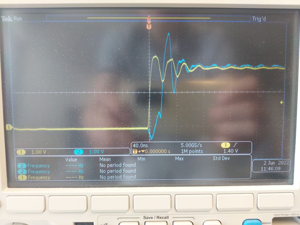

More examples with pictures from the oscilloscope:
The highest frequency i can achieve is at around 1.25MHz. But this is only when toggling and not doing anything else, which is not appliable for other projects.
1.25 MHz Toggle Signal1.25 MHz Toggle Signal
You can see that I achieve 1.25 MHz for the Signal Toggles (I routed them to a GPIO Pin thats why there are spikes besides of the oscilloscope quality of course)
FPGA toggles 20ns after the HPS ProcessorFPGA toggles 20ns after the HPS Processor
It can clearly be seen that the FPGA is toggling its own signal (the blue one) 20ns after the HPS has toggled (yellow signal). According to my C Code the HPS should toggle its signal now as soon as it has detected that the FPGA toggled its own signal. But this takes WAY longer than expected. It takes about 400ns for the processor to do so. But the CPU clock is ~1GHz ??
The processor takes way to longThe processor takes way to long

The access latency from lw_h2f bridge: for write access, it is about ~360ns, for read access, it is about ~420ns.
You can verify the result using a bare-metal code.
You can also use signal tap to monitor the real bus transaction and get the exact result.
MF28
1,568 Views
Hello!
Thank you very much for those informations! These timings were very helpful, because they explain a lot about my timing.
I was able to optimize everything so far that the data rate is pretty much maxed out with Linux with 3.3 MByte/s .
