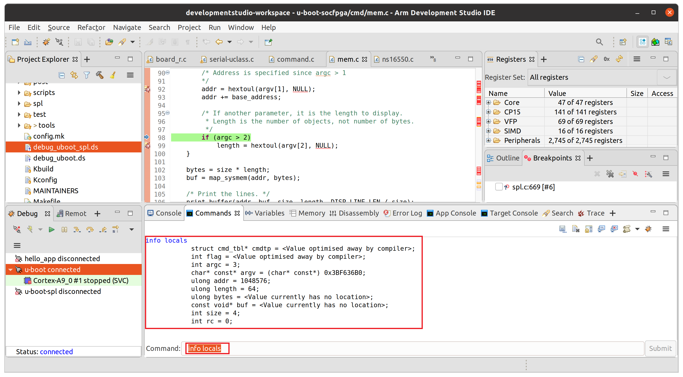

Continue stepping over, and at an appropriate point, type info locals in Commands to check local variables.
info locals
You can see that the value of addr is 1,048,576, which is the decimal value of the argument 0x100000. Click the Continue button on the Debug Control toolbar or type cont in Commands to resume execution. The values should be displayed on the serial console as shown below.
serial console md output
This concludes the U-Boot debugging.
