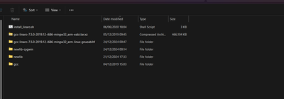

GirideshSekar
803 Views
Greeting, thankyou for your reply. i installed the arm -gnueabihf from the internet to make it work. This folder was not part of installation and linux based executions required this .  thanks
