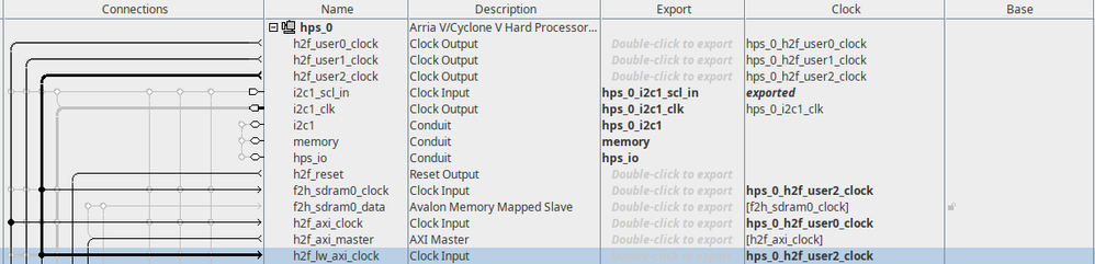

I noticed that in Platform Designer, the h2f_lw_axi_clock input signal takes its source from h2f_user2_clock. But the LW H2F bridge clock was &l4_main_clk. So I changed it in the Linux DT (not the overlay), like this:
&fpga_bridge0 {
	clocks = <&h2f_user2_clk>;
I could check the change in the live DT, but it didn't solve the issue.

I am not able to dump the live tree after I apply the overlay that enables the bridge, because the system freezes totally at this step. This is precisely what I'm trying to fix.
In the project, i.e. the Mercury+ SA2 ST1 Reference Design, the Platform Designer setup looks like this:
I checked that the handoff files in Barebox are up to date with the design. In the Barebox DT, I added these lines, just like in the Linux DT:
&fpga_bridge0 {
I confirmed that the clock is changed by dumping the live tree and before applying the overlay.

I noticed that in Barebox, the clock used in the default configuration of "fpga_bridge0" is enabled by default:
barebox@Enclustra Mercury+ SA2:/ clk_dump l4_main_clk
osc1 (rate 50000000, enable_count: 4, enabled)
    main_pll@40 (rate 1600000000, enable_count: 3, always enabled)
        mainclk@4c (rate 400000000, enable_count: 1, always enabled)
            l4_main_clk (rate 400000000, enable_count: 1, enabled)
On the other hand, the one that's used by the lw-h2f bridge in Platform Designer is disabled. I can enable it manually but it doesn't fix the crash.
barebox@Enclustra Mercury+ SA2:/ clk_dump h2f_user2_clk
osc1 (rate 50000000, enable_count: 3, enabled)
    sdram_pll@c0 (rate 800000000, enable_count: 0, always enabled)
        h2f_usr2_clk@d4 (rate 50000000, enable_count: 0, always enabled)
            h2f_user2_clk (rate 50000000, enable_count: 0, enabled)
barebox@Enclustra Mercury+ SA2:/ clk_enable h2f_user2_clk
    sdram_pll@c0 (rate 800000000, enable_count: 1, always enabled)
        h2f_usr2_clk@d4 (rate 50000000, enable_count: 1, always enabled)
            h2f_user2_clk (rate 50000000, enable_count: 1, enabled)
"h2f_usr2_clk@d4" is the parent of "h2f_user2_clk". I'm not sure which one I should use in the DTs (Barebox and Linux) as the clock of "fpga_bridge0". I tried both. But applying the overlay still crashes the system.
