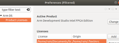

My PC environment:
virtual box 6.1 + Ubuntu18.04 on windows 10,
Quartus pro 20.1 linux version + SOC EDS pro 20.1 linux version + Arm development studio 2022.0 linux version.
hardware platform: Intel Arria 10 SOC development Kit with a 3 year arm tools license.
The arm ds was activated with the license.
and today, i followed the steps on SoCEDS and ARM Development Studio | Documentation | RocketBoards.org, to exercise the sample application.
after i imported the Altera-SoCFPGA-HardwareLib-Timer-A10-GNU.tar.gz into my workspace and completed the debugger setting as below:
after i click on Debug to start a debugging session, The debugger didn't download the sample application executable on the board, and didn't run it up to the main
function.
then i checked the commands window and found below errors
I searched these error on internet but found nothing usful for me. please give me your comments for this, thank you in advance.
