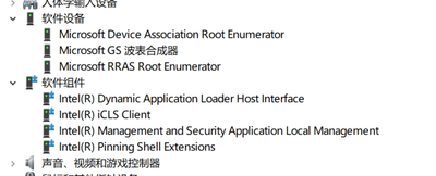

I just want to install SGX PSW to run Enclave project in hard ware mode. But I got trouble with activate BIOS setting for SGX.
Could anyone help me?
Thanks a lot.

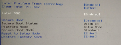

I have set SGX enable in my BIOS setting.
But when I install sgx_base.inf and sgx_psw.inf. Nothing happen and I can't find SGX driver in my device manager.
Then I tried to set intel SGX as "software controlled" and use this App to activate SGX.
After rebooting my computer, I just ran SampleSGXEnable.sln to test if SGX is activated. But it still told me to reboot to enable SGX which I have done servel times.

Thanks for your reply. But it seems that my os is installed in uefi mode. That's not the reason why my sgx psw can't be installed.
