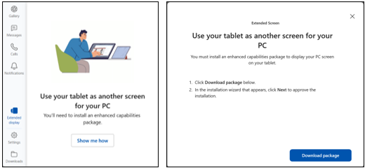

Step 1: To install Intel® Unison™ Extended Display
If Extended Display icon cannot be found in Intel® Unison™ PC App, install the enhancement package (it is mandatory for Premium feature) by download from Intel® Unison™ app additional driver
Or Extended display > Show me how > Download package.

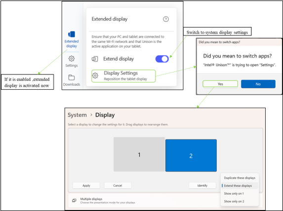

Step 2: To enable/disable Intel® Unison™ Extended Display feature

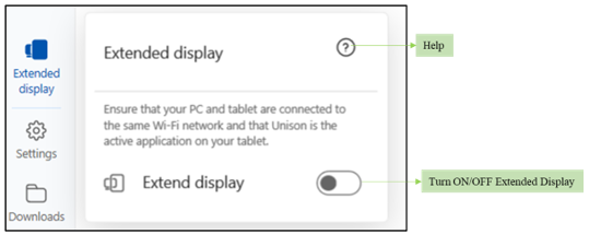

  1. Click Extended Display icon.
  2. Switch ON/OFF for Extended display
  3. Click Display Settings, it will prompt out Did you mean to switch apps?
  4. Click Yes > it will open Windows* Display settings

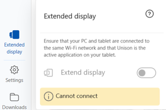

To check on an Error message of Cannot connect.
