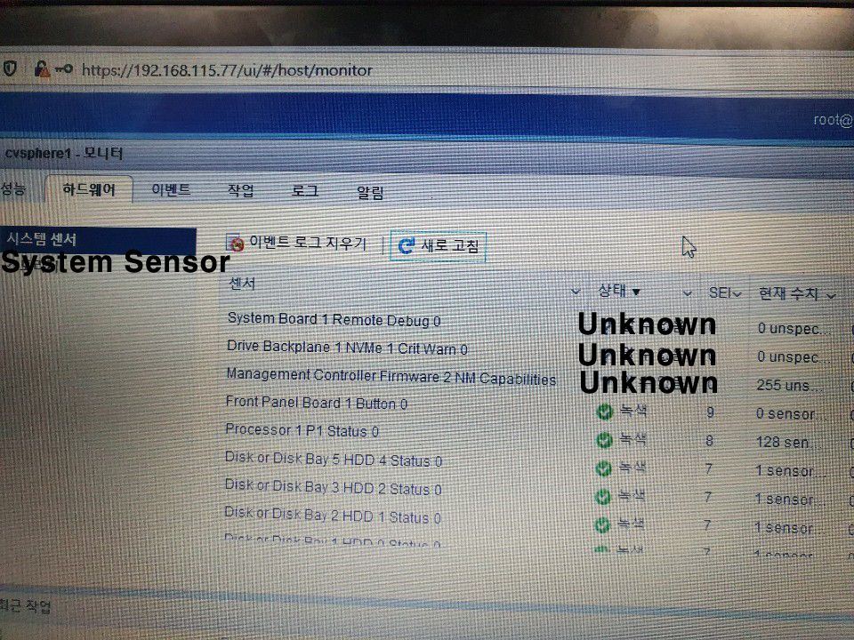

I am using Intel server system of S2600WFT motherboard. And I using Intel xeon gold 6134 cpu.
I want to use vsphere v6.7U3 from vmware, and the firmware version tested on vmware is SE5C620.86B.00.01.0001.060820170139 or SE5C620.86B.00.01.0002.062920170326.
However, no version exists on the Intel homepage.
I want to download this version of firmware.
please help me​.

One more thing. I tested fw 00.01.0009 and ​02.01.0008 and 02.01.0009.
And attatched vsphere logon screen.
In the system sensor category, 02.01.0008 has three unknown parts and 02.01.0009 has four, one more.
Lower firmware versions appear to reduce the number of unknown devices. So I need the lowest version of firmware​.
Or should I wait for the next firmware?​

I tried ESXi 6.7U3 with latest firmware, 02.01.0009, provided by Intel, but one unknown sensor was added compared to the previous version.
This case has four unknown sensor.
The customer has already installed vsphere and is in the process of servicing it, so it is not possible to downgrade the vsphere version.
​Please check to see if you need to change the BIOS settings.
thank you.​

SHeo0
3,292 Views
(1) System Management Software 2 KCS ...
(2) Management Controller Firmware 2 NM...
(3) System Board 1 Remote Debug 0
(4) Drive Backplane 1 NVME 1 Crit Warn 0
JoseH_Intel
3,292 Views
Hello SHeo0,
Engineering has explained this is a known issue of the VMware OS. Details in this VMware article:
https://kb.vmware.com/s/article/57171
"Hardware status is displayed as "unknown" for certain sensors on ESXi host (57171)"
In addition to the above, Intel does not recommend going back to older FW versions as they are missing fixes and improvements.
For further support please get in touch with VMware support:
https://www.vmware.com/support.html
https://communities.vmware.com/welcome

The information in the ipmi sdr list is defined by Intel, but it doesn't seem to ask vmware for the contents of the unknown device.
Please let Intel know the contents of the unknown device.
Isn't it the device on the motherboard after all?
And I have already contacted vmware but there is no answer.
I will not talk about old firmware.
I just want to know what is below.
And I want to know if this item is not a problem to use.
thank you.

Please take a look at the following:
The VMWare article shows how to identify the sensors belong to:
  • Presence sensors,
  • Disabled sensors,
  • Sensors with no reading available,
  • BIOS related,
  • Event-only sensors
  • Watchdog Sensors
And that is:
How to identify sensor belongs to one of the above mentioned category:
BIOS related sensor :Run 'esxcli hardware ipmi sdr list' command on the host. BIOS related sensor will have Entity-Instance column value "34.1"
Presence sensor : Run 'esxcli hardware ipmi sdr list' command and check below information for all sensors
  • Base Unit should be either 'enabled-discrete' or 'available-discrete'
  • Or Sensor Type should be 'Entity Presence'
Note : This data available only in 6.7 not in 6.5 U2
Disabled or No reading : Run /bin/cim-diagnostic.sh script.
In OMC_RawIpmiSensor class instances, check below fields for each entry:
ReadingStateUnavailable = true -> No reading sensors
Scanning disabled = true -> Disabled sensors
Event-only sensor : Use ipmitool and run below command:
'ipmitool sdr elist all'
 Check last column for 'Event-Only'entry.
Watchdog Sensor:
Running esxcli hardware ipmi sdr list command shows output watchdog sensors category as "Watchdog"
eg:
Sensor             Health   SEL entries Current reading  ID          Last updated Category Type/Unit
Other---0.35.0.212  Unknown  0              0             0.35.0.212     Unknown   Watchdog Unknown
For further support please contact VMware support.
