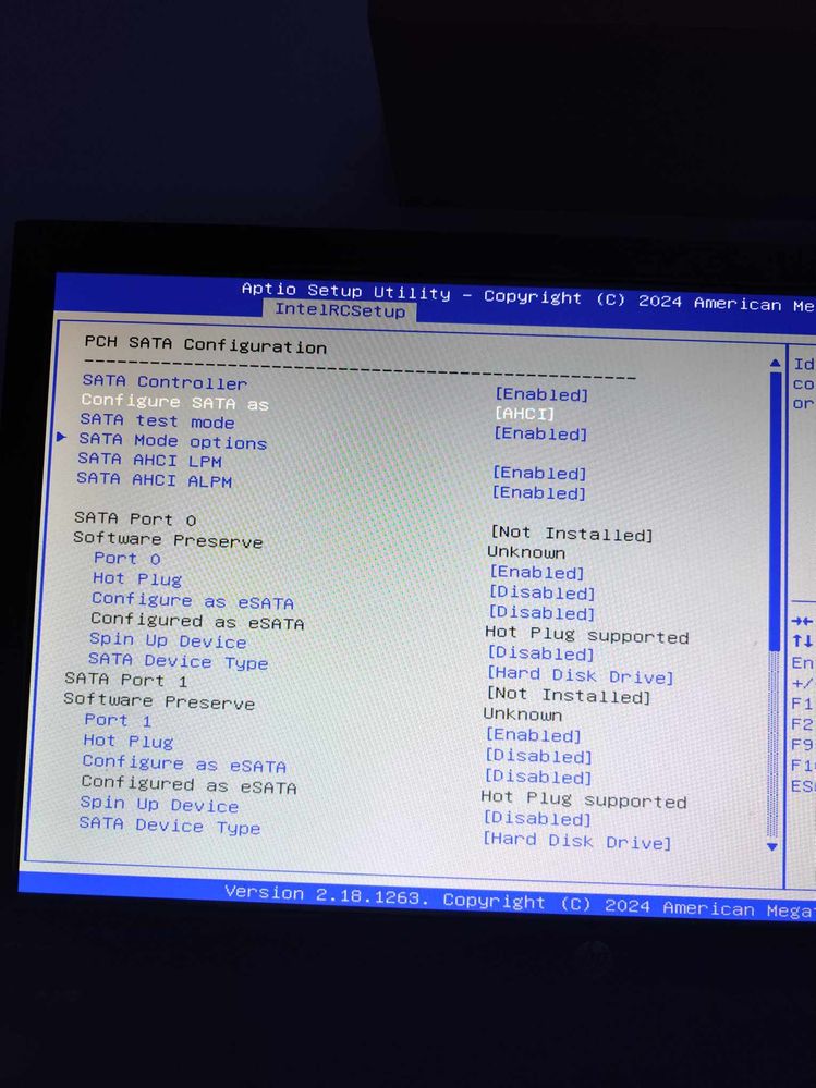

I did some searching in the bios and found something like this.I think it is useful

@Ponton
i seen video,  nvme device not there,
Enable  acpi, disable csm mode, enable uefi mode,  your bios support pcle gen 2 ssd only.
Try to clean ssd gold plate, reinsert it in the slot properly.   Try to check with another nvme ssd.
Also adjust the date and time correctly in bios
Ponton
2,663 Views
I used another ssd drive and it detected the drive,it means something with m2 was wrong after installing the system I will have more room to maneuver.Thanks in advance for all the hints.If I have a problem,I will get back to you!
