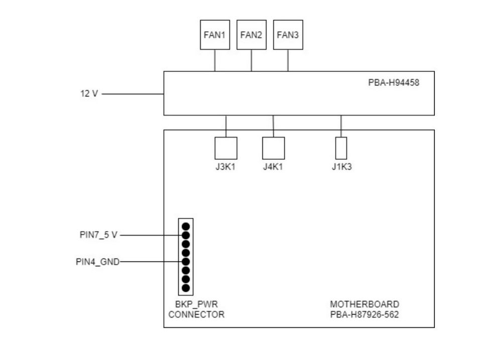

Hi All,
i'm configuring the S2600BPBR Board and we have some
problem. Below the configuration:
 - S2600BPBR Board
 - N°2 Processor Intel Xeon 4110 Octa core (8 Core) 2,10 GHz
 - N°2 Memory MTA36ASF4G72PZ-2G6J1 - 32GB RDIMM (on CPU 1 Slot A1 and CPU 2 Slot A1)
 - StandBy Power by BackUp Power Control Connector:
  a) GND on Pin 4
  b) 5V_STDBY on Pin 7
 - HDD connected by SAS Interface
We still working for a custom product and we are not using
the Intel Backplane.
When we supply the system, the Amber Led Blink and the LSB
Led stay fixed on the state 1010.
Can someone help?
I attached the video that show the malfunction.
Br, Paolo

PMari9
3,194 Views
SchematichDiagram.JPGDear Sergio,
like explaned, we are not using an Intel Backplane. We are developing a custom design.
We already work on the S2600TP and we supply the standby power by connector Backup Power
and everything work well.
I post to you the schematich diagram of the board connection, so you can understand better
the connection with board S2600BP.
At now, even by powering the card, as requested by the datasheet, the system freezes
during startup and the amber led beeps flash. It appears that the system is not running the
boot.
In the Schematic Diagram, the 12V is not supplye at now, for security
reason. We are using only the 5V on Backup Power Connector.
Can you supply as the minimal connection diagram of the board, so we can understand
if there is something wrong in the minimal connection diagram.
Br PMari.
