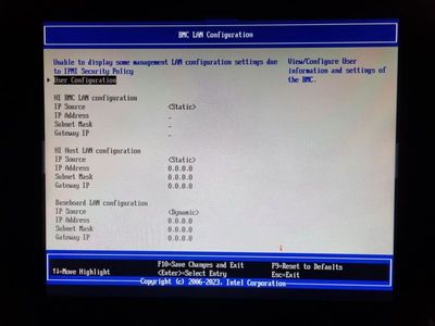

I forgot my BMC user password for an S2600STB mainboard. I cannot reset it using syscfg. The error message I get is "KCS Policy Control Mode is currently set to "RESTRICTED". "
There seems to be no jumper in the mainboard that would clear the BMC users. And when I go into the BIOS everything under user configuration is greyed out. There is mention of pressing F9 to reset to default, but it does not seem to work.
Is there a way I can reset the BMC user to defaults?

Could you please provide a screenshot of the BMC configuration in the BIOS where the password option is grayed out?
Dinesh
André21
5,091 Views
Hi Dinesh,
Thank you for your response.
I took some photos of the menus. I started at Server Management and worked my way through. After choosing "User Configuration" from the menu, an error message popped up. After closing it, the lower right corner contained "Configuration Changed". But I don't know which part.
I hope this helps.
