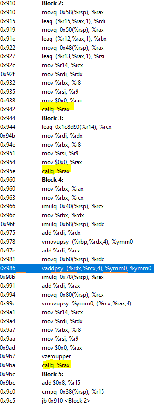

  1. Random call instructions are generated in critical loops when using parallel_for.

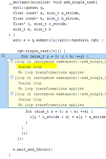

  2. No loop optimization is applied when using single_task.

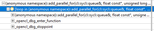

Intel Advisor reports,
  1. add_parallel_for,
    - call tree,
    - assembly,
  2. add_single_task,
    - source insights,
Are those call instructions necessary and is there a way to request the AOT/JIT compiler to not generate them? And for single_task, shouldn't optimization be applied as well (was simply interested to see how it fare against the host compiler optimization, add)?

/Zi tells the compiler to generate full debugging information and call instructions are generated when it enabled. Without this option, there are no callq instructions. Please, note that /Zi is not recommended to use in the release code. So, this is not a bug.

I reproduced the second issue (No loop optimization is applied when using single_task). Since this is a missed performance opportunity, I suppose it might be escalated as a feature request. I am presently investigating it and will get back to you shortly with an update.

/O2 /Zi /D "NDEBUG" /D "_CONSOLE" /D "_UNICODE" /D "UNICODE" /WX- /MD /EHsc /W1 /nologo /Fo"x64\Release\"
As to "which should translate to -O3 by clang-cl", as seen above, I'm using /O2 which is a msvc option, not a gcc/clang option. However, clang-cl should translate it to -O3.
Also, please, note that O0-O3 options are also supported by dpcpp \ icx compilers as well.
ChoonHo
7,444 Views
Yes, that works.
And the generated assembly is much much better, see attached image.
