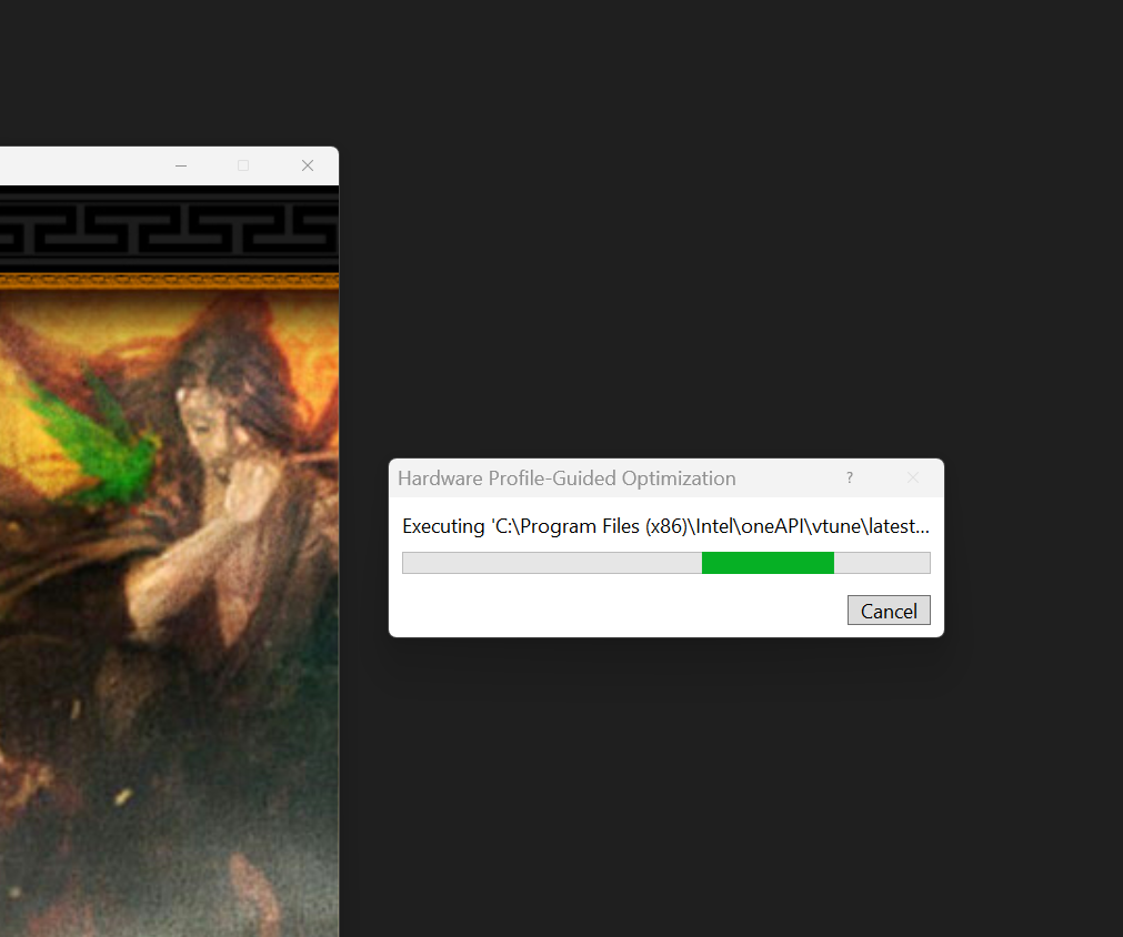

I build with this args (see 1.png) and when running test, my app running but execution process not finishing (see 2.png)
Thanks. Two follow-up questions:
- When stuck as shown in 2.png, is the TargetPath executable and/or the child process it launches still executing? Are one or both of them using CPU? You may need to consult Task Manager or similar.
- Do results change if you use "/fprofile-sample-generate=keep-all-opt" in 1.png and re-compile/re-profile? I'd advise against "max-fidelity" as this disables virtually all optimizations, and it does not typically improve profile fidelity. (It's mainly useful for identifying cases where optimizations interfere with feedback, but this is the exception.)
I tried fprofile-sample-generate=keep-all-opt now but its same.
for 1. question, yes my program opening and running normally..
At this sampling period SEP should not significantly slow or halt the application. Is the application expected to perform some computation and then exit on its own?
When the hang is happening, are both the parent and child process still running?
Have you been able to successfully run the collection (without hang) with a project without the child process arrangement?
My app is a game, its creating a Python thread with C API for GUI. My game running normally, so problem is just executing not finishing, so hwpgo cant collect infos.
(my game works normally even if the analysis execution gets stuck)
Have you been able to successfully run the collection (without hang) with a project without the child process arrangement? I am trying to confirm that SEP is working.
If so, could you try profiling your game by invoking it via sep on the command line?
Yea the problem is probably visual studio based. I can successfully analyze my app via command line..
Thanks. Yes, it sounds like there is an issue in the Visual Studio plugin's ability to collect the binary profile.
