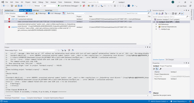

SeshaP_Intel
6,154 Views
We have tried OpenCV-4.7.0 and 4.5.5 versions and using the x64 Release configuration. Please provide the library dependencies if you have added any. We are facing linking errors related to OpenCV while building the code. Please find the error screenshot below.

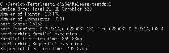

wdx04
6,028 Views
Yes, I got the same output on i7-7700HQ except for the device name and interation times:

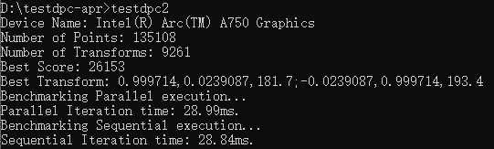

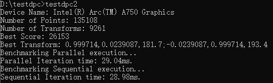

wdx04
5,042 Views
I see some speedup with the new driver, but not with the new compiler.
Old Compiler, New Driver:
New Compiler, New Driver:
The C++AMP version also benefits from the new driver:
