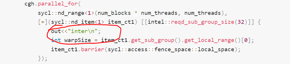

        int num_blocks=128;
    int num_threads=256;
    queue.submit([&](sycl::handler& cgh)
        sycl::stream out{ 4096, 128, cgh };
//         auto sharedmem = sycl::accessor<int, 1, sycl::access_mode::read_write, sycl::access::target::local>(11, cgh);
        cgh.parallel_for(
            sycl::nd_range<1>(num_blocks * num_threads, num_threads),
            [=](sycl::nd_item<1> item_ct1) [[intel::reqd_sub_group_size(32)]] {
                out<<"inter\n";
                int warpSize = item_ct1.get_sub_group().get_local_range()[0];
                item_ct1.barrier(sycl::access::fence_space::local_space);
    }).wait();
    status == 0 ? std::cout << "Verified: A = C" << std::endl : std::cout << "Failed: A != C" << std::endl;
    return status;

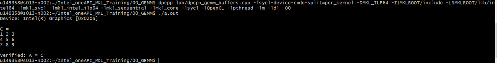

 Compile
dpcpp lab/dpcpp_gemm_buffers.cpp -fsycl-device-code-split=per_kernel -DMKL_ILP64 -I$MKLROOT/include -L$MKLROOT/lib/intel64 -lmkl_sycl -lmkl_intel_ilp64 -lmkl_sequential -lmkl_core -lsycl -lOpenCL -lpthread -lm -ldl -O0
Result:
Question:
There is printing in kernal, but actually there is no printed.
Subarnarek_G_Intel
4,952 Views
Hi Li,
Can you explain what you meant by "There is printing in kernel, but actually there is no printed."
Subarna
PcDack1
4,946 Views
Dear Subarna,
The correct result should be
Device:Intel Graphics [0x020a]
C=
1 2 3
4 5 6
7 8 9
inter
inter
verified:A=C
I don't see the "inter" being printed out.

Subarnarek_G_Intel
4,932 Views
Hi Li,
It gets displayed for me.
## u29878 is compiling oneMKL_introduction Module0 -- gemm with buffers - 1 of 3 dpcpp_gemm_buffers.cpp
Device: Intel(R) UHD Graphics P630 [0x3e96]
C =
1 2 3
4 5 6
7 8 9
inter

PcDack1
4,924 Views
Hi Subarna,
Thx, All my problems are on the ATS-P graphics card(on devcloud). You have only tested it on the P630 graphics card.
PcDack1
4,892 Views
Hi All,
First of all, I apologize for not describing the problem precisely. In order to make the problem more clear, my team and I, after repeated testing, found that the problem can be described in a simpler way(related to sycl::stream). I created a new post to describe the problem. The current post will no longer be maintained.
Thx all.
