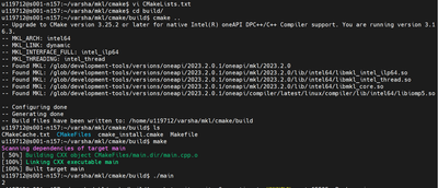

When we tried to run the CMakeLists provided by you, we were able to get errors but we have included the MKL directories properly. Could you please try the below-attached CMakeLists.txt using the sample reproducer code provided by you with GCC compiler as well as Intel LLVM compiler?
Please find the below screenshots for more details:
Using GNU Compiler
Using Intel LLVM Compiler
Could you please try and let us know if you are still facing any issues?
Thanks & Regards,
Varsha

Thank you for support again. The CMakeLists.txt you provide does fix the build process. From what I understand, the problem stemed from `find_package(MKL CONFIG REQUIRED)` and `pkg_search_module(MKL mkl-dynamic-lp64-iomp)` not properly loaded from environment variable `MKLROOT` because they actually expect `MKL_ROOT` to be defined instead, is that correct?
I would rather expect `find_package(MLK CONFIG REQUIRED)` to work out of the box. Maybe this should be considered a bug in `FindMKL.cmake`? Or a failure of the pacman package intel-oneapi-mkl to meet the environment expected by `cmake` and `MKL` to work together?
Also, I am confused because the project I'm working on does not use
as you suggest in your `CMakeLists.txt`, but
find_package(PkgConfig REQUIRED)
 instead, which still leads to the the same failure. What difference does it make?

>>The reason is that it expects `MKL_ROOT` to be defined but the environment only defines `MKLROOT`.
No, it is not a bug and by default, MKLROOT was defined by the setvars.sh environment. MKL_ROOT may be required for non-standard install locations. Could you please refer to the CMakeLists for more details:
https://www.intel.com/content/www/us/en/docs/onemkl/developer-guide-linux/2023-2/cmake-config-for-onemkl.html
Thanks and Regards,
Varsha
