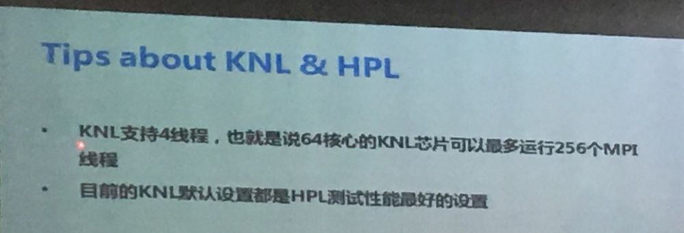

Thank you for your answer.
In a training course I learned that "KNL support 4 threads, in other words, this 7210 KNL can run up to 256 MPI threads." "The hardware setting is the best for HPL test currently."
So I said I can use all 256 threads.
And I tried to set
export OMP_NUM_THREADS=64
export MKL_NUM_THREADS=64
and run (mp_linpack) Intel® Optimized MP LINPACK Benchmark for Clusters, the result is still bad.
I try to google KMP_AFFINITY and I find this is a environment variables for OPENMP not MPI.  The software environment is Intel composer, Intel MPI and Intel MKL.
I also try it. But it seems still not works.( The results have some fluctuate, but there are still a big gap between this results and the theoretical performance.)
I have some questions.
1. As you say,
"A top performance on your KNL system will be when only 64 cores and 64 OpenMP threads are used ( spread across all cores )"
So how can I run the mp_linpack(Intel® Optimized MP LINPACK Benchmark for Clusters https://software.intel.com/en-us/node/528619) ? "./xhpl -n 83000 -b 336 " or "mpiexec -np 64 ./xhpl -n 83000 -b 336 -p 4 -q 16" or other?
2. I also tested the HPL2.2 and Intel® Optimized LINPACK Benchmark for Linux* (which runs on a single platform, https://software.intel.com/en-us/node/528615), but the result is still not good.
For HPL2.2, do you know how to test it ?
"mpiexec -np 64 ./xhpl" and in HPL.dat, N=83000 Nb=336 P=4 Q=16
or
 "mpiexec -np 256 ./xhpl" and in HPL.dat, N=83000 Nb=336 P=8 Q=32
or other?
And in the Intel® Optimized LINPACK Benchmark for Linux* Developer Guide , there are only brief introduction, no input files introduction. How to test it?
 3.The theoretical performance to a single Intel(R) Xeon Phi(TM) CPU 7210 node is 2662.4Gflops.  But the top result I get is 716.506Gflops. This confused me much. How to get close to the theoretical performance?
Thanks.
Sergey Kostrov wrote:
>>... I learned from a material that When I running HPL on this platform, I can use all 256 threads...
A top performance on your KNL system will be when only 64 cores and 64 OpenMP threads are used ( spread across all cores ). That is,
need to be executed instead.
Also, try to set KMP_AFFINITY environment variable to:
export KMP_AFFINITY=scatter
or
export KMP_AFFINITY=scatter,verbose
With KMP_AFFINITY set to compact or balanced modes performance could be worse when compared to scatter mode. I recommend you to test all of these modes.
