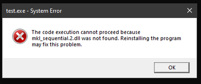

I removed mkl_sequential.2.dll and the build is fine (screen shot):
But, when I run the program, I get
The only way to avoid this error seems to be to add mkl_sequential.2.dll in the ... Common7/IDE folder.

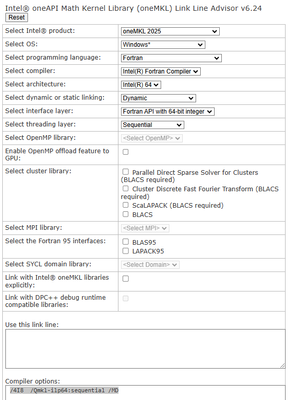

Are you familiar with dynamic linking and static linking? The .dll files in Windows mean dynamic linking. What I showed you above is a static linking solution. It seems that you need a dynamic linking solution. I edited the configuration in https://www.intel.com/content/www/us/en/developer/tools/oneapi/onemkl-link-line-advisor.html
accordingly. and it shows that you need nothing for linking flag, and you need "/4I8 /Qmkl-ilp64:sequential /MD" for compile flag. Do you know which button in your VS panel to hit and which fields to edit to put in the above flags? Do you know which button to click to instruct VS to print out the build(compile/link) command? The above error seems like you compile the test code in a static linking way, but run it as a dynamic linking app.
