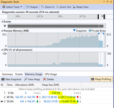

Ahmadi__Afshin
14,093 Views
Hi Khan,
I am very sorry for the delay. Please find below the information that you need to reproduce the issue.
1. Download the Visual Studio project files from the following link:
https://drive.google.com/file/d/18qDK-SoH5NQbItKElSxVW5j52lrfKWPV/view?usp=sharing
2. I have already configured the project file with necessary command line arguments. All you need to do is to run the solution from within Visual Studio. There are three breakpoints in the main routine (lines 15, 95, 97). Use the "Take Snapshot" button to take memory snapshots at each breakpoint.
3. As you can see in the picture, there is about 87MB of the heap memory that was not cleared after deleting the classes. I only use  C++ vectors and MKL arrays in those classes (i.e., MKL is only used in PFCase.h). When a class is deleted, vectors are automatically released and freed from memory (I tested this separately). For MKL arrays, I placed the MKL memory free functions in the class destructor. So it is very likely that MKL is just making memory available to the OS and not releasing it.
I used VS 2019 and OneAPI 2021.3 version to perform this test.
Thank you,
Afshin
shb
12,877 Views
Hello Afshin,
After I debugged in your provided project, I found out that you call "mkl_sparse_z_create_csr()" function unnecessarily for "YbusdiagVnorm_CSR" and "YbusdiagV_CSR" sparse matrix handles after you got them as outputs of the previous "mkl_sparse_spmm()" calls, which have internally allocated memory as part of the handle, in the dS_dV_Sparse() function.
By calling "mkl_sparse_z_create_csr()" function on the matrix handle you already created, it will overwrite the previous handle's information as newly created handle so that we lost the information of the handle's data is owned by library as well as having memory leak for the old sparse handle itself, even though you are using the same pointers as input for the sparse matrix handle.  Due to the overwriting of the information of "owned by library", when "mkl_sparse_destroy()" is called on those sparse matrix handles, the function didn't release the data assigned on the handle, which supposed to be released and that's why we got those memory leak behavior.
In fact, you don't need to call "mkl_sparse_z_create_csr()" for those handles, since they are remaining even after calling "mkl_sparse_z_export_csr()" on them.  After I just commented out those two function calls, there is no memory leak occurs anymore, as shown below:
output_with_mkl_nightly_ats_20230116_win_after_fixing_the_bug.pngoutput_with_mkl_nightly_ats_20230116_win_after_fixing_the_bug.png
If you have any questions for this, please let us know.
Best,
Seung-hee
