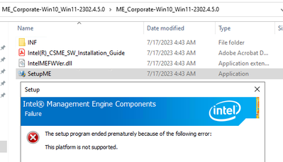

Jools86
New Contributor III
18,055 Views
Hi Miguel,
Looks like the setupme.exe is looking for an IOT device?
Julian.
MIGUEL_C_Intel
18,047 Views
Hello, Jools86,
I hope this post finds you well.
The driver works for Intel® NUCs with Windows 10 and 11.
Do you mind sending us the results of running Intel® System Support Utility for Windows?  I will send the information to the engineering team for further investigation.
Intel® System Support Utility for Windows 2.5.0.34
https://www.intel.com/content/www/us/en/download/18377/intel-system-support-utility-for-windows.html
Miguel C.
Jools86
New Contributor III
18,044 Views
I was told (earlier on in this thread), that the driver is generic and would work with all models, not juct NUCS?
MIGUEL_C_Intel
18,030 Views
Hello, Jools86,
I am sorry for the misunderstanding.
I was referring to the ME driver working on regular PCs, not only for IoT devices.
The log requested is intended for further investigation.
I look forward to hearing from you.
Miguel C.
