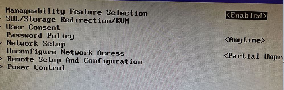

  • I have a DELL Optiplex Micro Plus 7010 with CPU 13th Gen Intel(R) Core(TM) i7-13700T.
I need to remote control this computer via Intel AMT.
I enabled and set AMT/MEBx settings as below images show
  • On MeshCommander, I set computer
I can ping ip 192.168.9.17, but when I try to connect, I got below error
On Intel Manageability Commander, I got error
I can connect from web browser to https://192.168.9.17:16993, but can't find Remote Desktop option
How can I get remote desktop control to this DELL Optiplex Micro Plus 7010 from AMT through application like MeshCommander or Intel Manageability Commander?
Welcome to any suggestion!

Hello Steven_Ca,
In regards to your AMT configuration, it looks okay; however, you need to bear in mind that mesh commander is a third-party option for having remote access to endpoints and is no longer a validated one since the support for it is no longer being given by their developers, you can find more information on it below.
https://www.meshcommander.com/meshcommander
Additionally, the Intel manageability commander (IMC) is still supported but not as actively supported and updated as our Intel® Endpoint Management Assistant (Intel® EMA), which is our most current, actively supported, and continuously updated tool; therefore, with more current AMT versions you will encounter a problem if you use IMC.
You can find all the information on how to use EMA in the links below, just bear in mind that EMA is more of an enterprise option than the ones previously mentioned.
Guide to EMA and AMT in the Intel vPro® Platform
https://www.intel.la/content/www/xl/es/business/enterprise-computers/resources/how-to-guide-intel-vpro-ema-amt.html
Intel® Endpoint Management Assistant (Intel® EMA) Single Server Installation and Maintenance Guide
https://www.intel.com/content/www/us/en/support/articles/000055629/software/manageability-products.html
Intel® Endpoint Management Assistant (Intel® EMA) Admin and Usage Guide
https://www.intel.com/content/www/us/en/support/articles/000055619/software/manageability-products.html
Intel® Endpoint Management Assistant (Intel® EMA) Quick Start Guide
https://www.intel.com/content/www/us/en/support/articles/000055627/software/manageability-products.html
Intel® Endpoint Management Assistant (Intel® EMA) Video Series
https://www.intel.com/content/www/us/en/support/articles/000056028/software/manageability-products.html
In case you don’t think EMA is the right fit for your project we would recommend looking for a different tool to handle the remote access part of your endpoint(s) and that is fully compatible with AMT.

Steven_Ca
5,188 Views
After install EMA and DELL Command Intel vPro out-of-Band on my computer, I can remote desktop to DELL Optiplex Micro 7010.
Thank you all for your suggestion.
