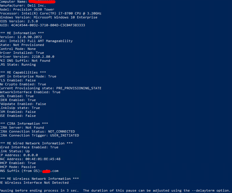

I have 2 PCs. One is provisioning fine. The other constantly fails.

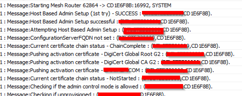

Successful:

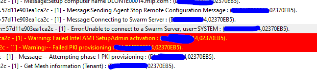

Failure:
(from Manageability logs):
2022-12-01 18_54_10-Configuration Manager Trace Log Tool - [C__temp_EMALog-ManageabilityServer.log].png
On the failed machine, I get this INVALID_STATE message, on the FAILED machine AMT is de-provisioned, I am struggling to work out why this is happening.
Both machines have the same build. I have performed the following on the machine which wont provision:
  • Installed IME drivers
  • Re-provisioned / De-provisioned AMT via BIOS / ACUConfig multiple times
  • Failure Machine has same DNS suffix and DNS / IP subnet as Successful machine
But for whatever reason this machine wont provision. I have even Disabled and re-enabled Manageability features witin MEBx but to no avail.
Any pointers as to what "INVALID_State" could mean?
