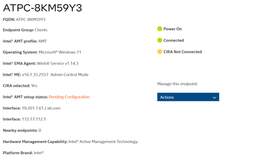

I'm trying to get Intel Endpoint Management Assistant to work. I have successfully provisioned a device in ACM. But "CIRA Not Connected"
The devices I try to onboard, are WiFi Only devices, Latitude 7450, Latitude 7440 etc.
Intel® ME: v18.0.10.2351  Admin Control Mode
CIRA selected: Yes
Intel® AMT setup status: Pending Configuration
Hardware Management Capability: Intel® Active Management Technology
Platform Brand: Intel vPro® Enterprise
Power On
Connected
CIRA Not Connected
When I disable the WiFi Profile in the AMT-Profile, Intel® AMT setup status: succeeds.
When I add the WiFi Profile, it's stuck "Pending Configuration"

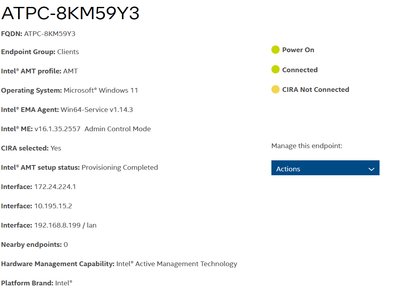

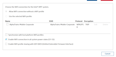

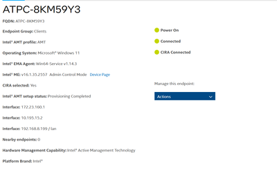

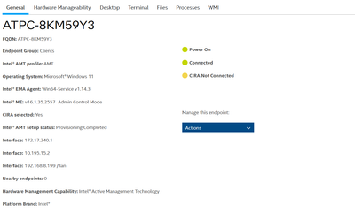

When I disable WiFi - It works:
When I enable WiFi it becomes stuck on 2 Clients (Dell Latitude 7440 and Dell Latitude 7450)

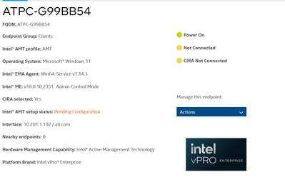

Another client / showing a fancy Intel Logo the other one doesnt but result is the same:
Log file of the Managebility Server & Log from Client attached

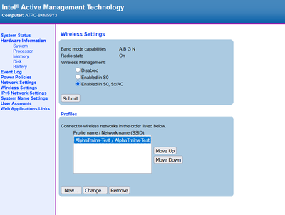

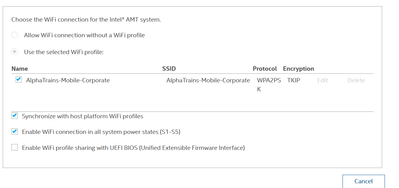

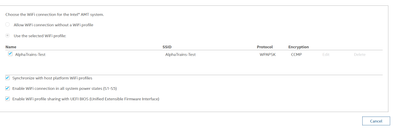

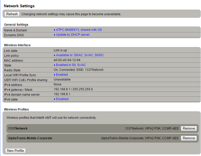

I digged a bit deeper and found this. I configured some dummy WiFi, "AlphaTrains-Test" with 12345678 as password. This synced just fine:
Only difference is that I tried WPA CCMP + Simple Password. The profile syncs perfectly to the client.
As soon as I configure WPA2-PSK with our production SSID and complex password, the device seems to fail.
Why would that be? Surely the devices should support WPA2-PSK.
Also I noticed that if you login to the local EMA web-interface the settings are pushed properly:
CIRA still shows as disconnected, even though I deployed this AlphaTrains-Test WiFi..

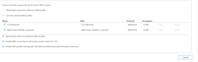

AlphaSeb
7,129 Views

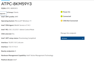

Thanks Vishal,
I resolved the WiFi issue
  • TKIP is considered legacy and insecure, hence CCMP is enforced by the AMT Firmware (according to ChatGPT) this was a mistake on my end. I thought TKIP would be the better standard, however CCMP is better and thats also how our WiFi is configured.
  • That explains why TKIP is not an option in the localhost/AMT Webinterface
  • I configured the WiFi now to use CCMP
  • Then I noticed, that it had problems with our 64 Char ASCII Passphrase. AMT only supports 64-char-HEX and 63 Char-Ascii passwords. So I removed 1 character from the password and the issue was resolved as well.
The Wifi now deploys correctly! No more "pending configuration"
However CIRA still shows as "Not connected"
I will proceed with your outlined troubleshooting steps.
443 and 8080 TCP are available over the internet, that should be enough when I preconfigure the device via USB-key or Dell Factory right?
AlphaSeb
5,843 Views
I might add that as soon as I enable:
I have this error in the log:
2025-08-07 21:02:21.0502|WARN||9116|89|SetWirelessUefiWiFiProfileShareEnabledOption - MeshManageabilityServer.code.AmtSetup.WirelessManager, EMAManageabilityServer, Version=1.14.3.0, Culture=neutral, PublicKeyToken=57d11e903ea1ca2c - [1] - Unable to set UEFIWiFiProfileShareEnabled to True. : (ATPC-8KM59Y3,342CFF7D).
Exception Level(0):WSManFault.Code: a:Sender WSManFault.SubCode: e:UnsupportedFeature
StackTrace Level(0): at Intel.Manageability.WSManagement.DotNetWSManClient.WSManSendReceive(Header header, XmlElement[] bodyIn, XmlElement[]& bodyOut)
at Intel.Manageability.WSManagement.DotNetWSManClient.Put(Uri resourceUri, XmlElement content, IEnumerable`1 selectors)
at ManageabilityStack.AmtWireless.SetupUefiWiFiProfileShareEnabledOption(Boolean enabled)
at MeshManageabilityServer.code.AmtSetup.WirelessManager.SetWirelessUefiWiFiProfileShareEnabledOption(Boolean enabled)
However: Provisioning still completes without an error.
Could you please confirm, that this setting is not needed? If it is needed, how do I get this to work?

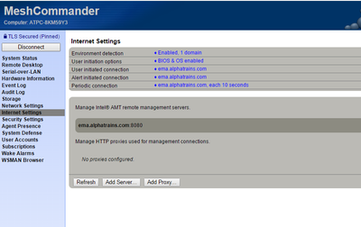

Can you confirm that .eu Domains are working? I found this, and now I'm not sure if this is the root cause:
https://software.intel.com/sites/manageability/AMT_Implementation_and_Reference_Guide/default.htm?turl=WordDocuments%2Fpkicertificateverificationmethods.htm
Client shows:
*** CIRA Information ***
CIRA Server: Not Found
CIRA Connection Status: NOT_CONNECTED
CIRA Connection Trigger: USER_INITIATED

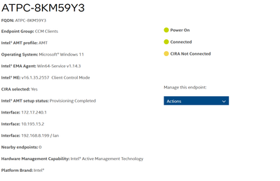

AlphaSeb
7,104 Views
CCM
Logs attached
CIRA now shows as "Connecting..." but no success.
Network issue?
.tld issue?
Edit: After a few mins it goes to:

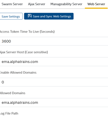

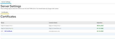

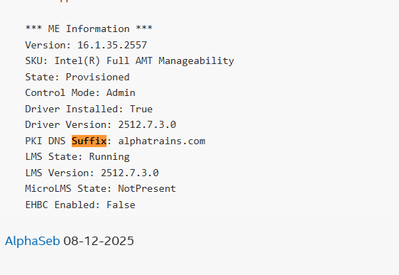

AlphaSeb
6,971 Views

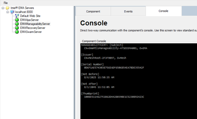

Did all that.  Logs attached, nothing changed.
When checking the server on port 8080, it is showing the built-in cert. Should it not report my PKI cert?
openssl s_client -connect ema.alphatrains.eu:8080 -showcerts
Connecting to 52.233.167.88
CONNECTED(000001F8)
depth=0 O=Mesh, CN=ema.alphatrains.eu
verify error:num=20:unable to get local issuer certificate
verify return:1
verify error:num=21:unable to verify the first certificate
verify return:1
verify return:1

Dear Vishal,
after revising my config, reinstalling the certs, creating a new USB-Stick etc.
I got it working like this now:
  • CIRAconnected
  • Admin Control Mode
  • Provisioning completed
  • WiFi Profiles installed
  • KVM via AMT, without consent works as expected, when the OS is online
  • KVM via AMT does NOT work, when the OS is offline. e.g. "Reset to BIOS"  - the device resets, and is showing the BIOS but I can't connect anymore
  • CIRA is "Not connected" when the device is Out of Band
  • CIRA is only connected when the device is In-Band
I went through all the hoops to make this software working, and now the most important part seems not to work? In my other topic I was told, that Out of Band Management only works when you purchased a certificate and provision devices in ACM mode.
Well, thats what I did now - and it still does not work?!
I have Dell Laptops with vPro Certification, so I'd expect this to work?

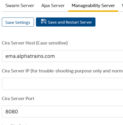

AlphaSeb
5,569 Views
I have the certificate with .com tld now.
  • Adjusted Entra ID login
  • Adjusted Managebility Server FQDN
  • WebServer FQDN
  • Allowed Domains
  • Uploaded the certs (PFX with password, and whole chain)
  • Changed AMT AutoSetup Profile to use new Cert
  • Restarted the whole server
  • Recreated the USBStick with USBFile
  • Uninstalled Agent
  • Ran "C:\Program Files (x86)\Intel\EMAConfigTool\EMAConfigTool.exe" --unconfigure
  • Went into F12>Intel Management Extension>Disable
  • Rebooted
  • Went into F12>Intel Management Extension>Enable
  • Put the USB-Stick in, rebooted
  • Applied config
  • Reinstalled Agent
Even though CIRA was connected before (in ACM, but over the Agent, like you said) it's now "Not connected"
  • Platform Manager didn't work anymore, so
  • Went here C:\Program Files (x86)\Intel\Platform Manager\Platform Manager Server
  • Updated settings.txt with new UPN
  • Logged in, works
  • Console still showing this weird MeshRoot, I'd expect it to show my PKI Cert??
  • Confirmed with OpenSSL (see attached)
  • Confirmed with EMAConfigTool (see attached)

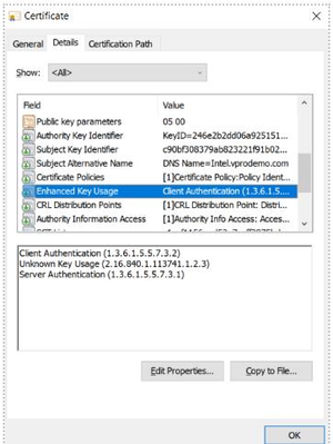

AlphaSeb
5,207 Views
Dear Vishal,
1) PKI DNS Suffix has been added, using the USBFile (setup.bin) + USB Stick method. The client log I have attached yesterday, so that should be visible to you:
2) Screenshot of the certificate installed in Computer/User Personal Store
The very same cert, is also installed here and detected as PKI Cert.
Would it possible to have a call during German business hours? This back and forth here is quite time consuming.
