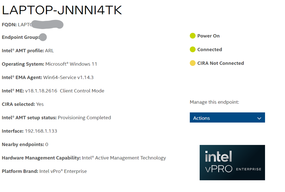

I’ve set up a local EMA server and trying to connect a DUT to it for AMT testing. According to the documentation, I was able to provision the DUT successfully via EMA, but it fails to connect to CIRA.
Using the EMAConfigTool, I found that the AMT IP address was not assigned—it's also showing as 0.0.0.0 in the AMT Web UI.
However, if I manually provision the DUT by MEBX not EMA, the AMT IP will get assigned correctly and can access DUT via the AMT Web UI. Despite this, the CIRA connection still fails in EMA.
Could you help me figure out what’s causing the issue? Thank you!

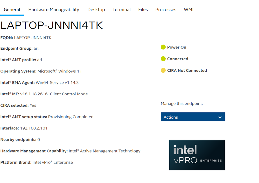

I install a new EMA server to windows server 2019 but still cannot connect CIRA.

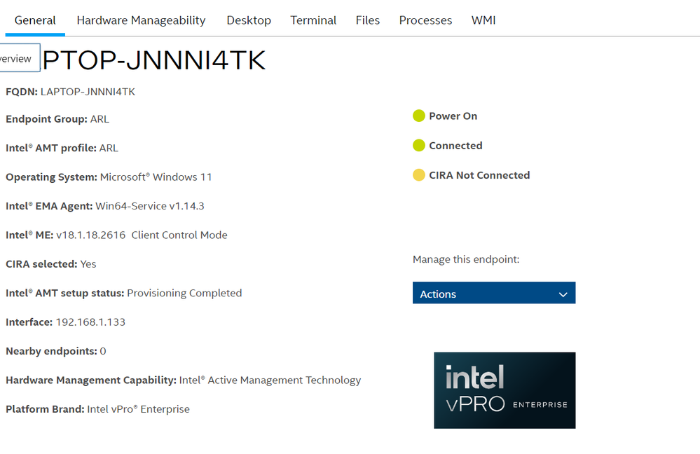

1. Unmanage the Endpoint from EMA Console
· Log in to the Intel® EMA web console as Tenant Admin.
· Navigate to Endpoints.
· Locate the endpoint PTOP-JNNNI4TK and click View.
· Click on Actions > Stop Managing Endpoint > Take Action.
2. Uninstall the EMA Agent from the Endpoint
· Log in to the endpoint.
· Right-click on the EMA agent installer and select Run as Administrator.
· Choose to Uninstall the agent.
· After uninstallation, delete the agent files from the system.
3. Unprovision the Endpoint from MEBx
· Reboot the endpoint.
· During boot, press Ctrl + P to enter MEBx.
· Perform a Full Unprovision of the endpoint.
4. Create a New Endpoint Group and AMT Profile
· In the EMA console, create a new Endpoint Group and a new Intel® AMT Profile.
· Configure the AMT Profile with the following settings:
· General: Select Always use Intel AMT CIRA
· Power States: Select Any time system is connected to power
· Management Interfaces: Enable KVM, Web-Based UI, Serial Over LAN
· FQDN Source: Select Shared with Host OS
· IP Address: Select From the DHCP Server
· Wi-Fi:
· Enable Synchronize with host platform Wi-Fi profiles
· Enable Wi-Fi connection in all system states (S1–S5)
· Save the profile.
5. Apply the Profile and Reinstall the Agent
· Go to the Endpoint Group > Actions > View Configuration > Intel® AMT Auto Setup.
· Select the new AMT profile, then Save.
· Generate and download the new EMA agent files.
· Install the agent on the endpoint.
6. Verify and Share Status
· Wait a few minutes after installation.
· Check the endpoint status in EMA.
· If CIRA is connected, it should appear in green or yellow.
· Please share a screenshot of the status with us.
Vijay N
Intel Customer Support
Hi
I follow your step but not work... CIRA still no connect...

Sorry for the late reply! I found that when the target device receives its IP address through the router’s DHCP, it fails to connect to CIRA. However, when I configure both DHCP and DNS on the Windows Server (instead of using the router), CIRA connects successfully.
