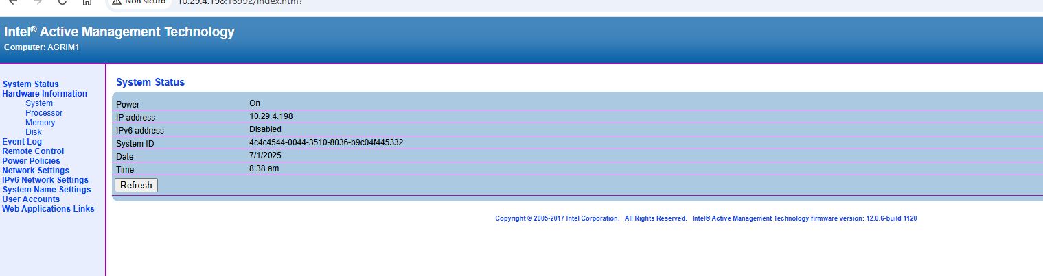

we are having a really strange problem. We have a perfectly functioning EMA Server with 6 AMT Clients connected; CIRA OK.
From the same SERVER, with the same agent, we tried to deploy new clients, CIRA does not connects.
Analyzing the client side problem, we notice that the IP of the ema server in the CIRA section is wrong, unknown, never entered anywhere.
How is this possible? in the attached example "OK" = correct client settings --> "CIRA SERVER=ema-server"; example "KO" = client with fake IP in the "CIRA Server" filed.
Where does that IP come from? How is it possible that with the same agent, same network conditions, and the same procedure something like this happens?
The ip of ema-server is 10.222.16.165
The ip that is shown in the "KO" client for CIRA server field is 10.46.7.198 ? what is this ?

For clarety, the issue is that: for some unkow reason on some unprovisioned client, when we install the EMAAgent, in the CIRA SERVER filed of the AMT is pushed (or from the installer or from the Server during the provisioning stage) an UNKOW IP (10.46.7.198) that we don't know it comes from. Address of the EMA-SERVER is 10.222.16.165. On the "OK" clients in that flied was correctly pushed the DNS name of the EMA-SERVER "ema-server" and CIRA works.
It is quite strange that in an UNKNOW IP is pushed in the AMT, instead before, the correct dns name of the ema server was pushed. Nothing is changed and dns resolution on KO clients correclty point to the right IP.
It is possibile to manually edit on the AMT of the KO clients the CIRA SERVER Filed (under cira information) to make it point to the right dns EMA-SERVER name and make CIRA works again?

For clarety, the issue - on 5 different clients - is that: when we run the EMAAgent.exe / .msh in the CIRA Server filed of the Clients (AMT) is pushed an IP (10.46.7.198) that we don' t know from where is taken (EMA Server is 10.222.16.165). From these client dns resolution of ema-server correct reach 10.222.16.165. In band monitoring correctly works. CIRA obviusly not.
With the same EMAAgent.exe / .msh - previously - on different 6 Client in that Filed of AMT (CIRA SERVER) was correctly pushed the name "ema-server".
Is there a way for manually modify that field in amt to get CIRA works ? the CIRA Server Filed on AMT needs to be corrected from 10.46.7.198 (unknow IP) to ema-server (correct dns name of the EMA SERVER that usually was pushed in the clients "before").
It is quite strage that an unknow IP is pushed from the installer or from the EMA server in the "provisiong operations" in the "CIRA Server Filed" (under *** CIRA Information ***) of an AMT ... in-band functionallity (from OS) correctly works.

However the issue is not client side (also because AGRIM1 is one of 5 clients that have the same issue)
See this: https://community.intel.com/t5/Intel-vPro-Platform/Round2Provisioning-ISSUE-UNKNOW-IP/td-p/1700872
The issue is in the "Round2Provisioning" commited by the server to the client.

As per the ECT, we believe that there could be an existence of a second EMA instance, please let us know how many EMA servers and DNS has been used, it would be great if you can share us the network diagram of the Intel EMA environment.
We would suggest you gather the endpoint group and the AMT profile from working profile.
Then proceed with the following steps:
- Access the Intel® Endpoint Management Assistant (Intel® EMA) using your tenant credentials.
- From the left toolbar, select Endpoints.
- Click View next to the endpoint you wish to unprovision.
- Under Actions, select Stop managing the Endpoint.
- In the new window, choose Remove Provisioning (first option at the bottom).
- Access the endpoint, uninstall and delete the old agent files, and then restart the system.
- During the reboot, press Ctrl + P to enter MEBx, log in, and perform a full unprovision.
- Download the agent file from the working machine, reinstall it on the endpoint, and allow around 5 minutes for CIRA to connect.
Once done, kindly generate the latest ECT logs and also share the FQDN with us.

For now i thank you so much again and go ahed; you can close all my tickets.
BR
Marco dB
