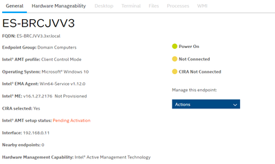

I have Intel EMA v1.12.2.0 installed on the server
Some computers in my environment have a processor with vPro technology, so I would like to configure Intel AMT.
After adding the computer to EMA, I can connect to it, but the CIRA status is "Not Connected" and the Intel AMT setup status is "Pending Activation"
When I enter Provision Intel AMT it looks like this:
I tried to install "Intel-SA-00075 Detection Tool" on the client's computer, but I receive the following information:
"This system is not vulnerable; the ME SKU is not affected"
I also tried installing "Intel® Setup and Configuration Software (Intel® SCS)" but I guess this software is no longer available
Intel Management Engine - the Intel chipset driver is necessary to run Intel AMT on the workstation, but I don't really know where to download it from
Please help me how to configure Intel AMT

VolTwins
14,582 Views
Hello @Arun_Intel1
On my computer, where I want to configure Intel EMA, after downloading the "Intel EMA configuration tool" and entering the --verbose command, I received:
*** SMBIOS Information ***
AMT Supported: True
AMT Enabled: True
SMBIOS ME SKU: Intel(R) Full AMT Manageability
SMBIOS ME Version: 16.1.27.2176
KVM Supported: True
SOL Supported: True
USB-R supported in BIOS: True
RSE Supported: True
*** ME Information ***
State: Not Provisioned
Control Mode: None
Driver Installed: True
Driver Version: 2406.5.5.0
PKI DNS Suffix: Not Found
LMS State: Running
LMS Version: 2406.5.5.0
MicroLMS State: NotPresent
EHBC Enabled: False
*** ME Capabilities ***
AMT in Enterprise Mode: True
TLS Enabled: False
HW Crypto Enabled: True
Current Provisioning state: PRE_PROVISIONING_STATE
NetworkInterface Enabled: True
SOL Enabled: True
IDER Enabled: True
FWUpdate Enabled: False
LinkIsUp state: False
KVM Enabled: False
RSE Enabled: True
*** CIRA Information ***
CIRA Server: Not Found
CIRA Connection Status: NOT_CONNECTED
CIRA Connection Trigger: USER_INITIATED
*** ME Wired Network Information ***
Wired Interface Enabled: True
Link Status: Down
IP Address: 0.0.0.0
MAC Address: AC:91:A1:23:5A:36
DHCP Enabled: True
DHCP Mode: Active
DNS Suffix (from OS): Not Found
*** ME Wireless Network Information ***
Wireless Interface Enabled: False
Link Status: Down
IP Address: 0.0.0.0
MAC Address: Information Unavailable
DHCP Enabled: True
DHCP Mode: Unknown
The computer meets the requirements and I know that the computer does not see CIRA Server, my question is what do I need to do now to fix it?

VolTwins
14,377 Views
Hello @Arun_Intel1
Intel AMT profile: CCM
In the attachment I am sending a photo of the current status of the computer
Best regards

VolTwins
14,118 Views
Hello @Arun_Intel1
I sent a photo of the current configuration and the EMA agent is installed on the target computer, I can connect to it and, with permission, I can use the computer to which I am connecting via EMA. Everything works correctly and EMA is installed not using Intune, but is installed from GPO, this does not change the fact that the installation is successful and everything works, but CIRA / AMT does not work, as I explained above and as I sent the configuration photos. I am asking for further help.
Best regards

VolTwins
14,041 Views
Hello @Arun_Intel1
I am referring to this photo:
When the computer is turned on, every function works, only Intel AMT setup status is still "pending activation" and I cannot use CIRA, so I do not need to install the EMA agent again.
