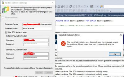

Hello, I use Azure resources for my EMA server (version 1.14.1.0)
-Azure VM
-Azure SQL server
I have configured my Intel EMA server and got it worked. Then I am trying to set up replica sql server and getting next problem when trying to change database server:
It is very strange because this user is Server admin which I used during initial set up process.
In azure sql I cannot add some other admin user.

Hi Yauheni,
Greetings!
We see that the EMA server and the General purpose SQL on the Azure are on different virtual machine (Different servers) where you are trying to replicate or duplicate the SQL server, upon which you are getting an error which says "The Specified installer user does not have the required access to continue. Please grant the user required role and try again".
We would like to inform you that we would be able to backup the SQL server but not duplicate it, as there would be two SQL's to which EMA server would be pointing.
Hence we would be able to back up the SQL server if required.

This is just a read-only replica of EMADatabase in different region for disaster recovery, and EMA server is pointing to only 1 server not 2.
For what reason there is an option to update database settings? Only for switching to empty database and or new sql server?
And strange behavior is when I don't change any option in update database settings window and just click update I see the same error.

Yauheni
초급자
3,583 조회수
I got it, what about my previous question:
I still want to know why I can't switch to another server from EMA installer or even just update settings with the current server.

Yauheni
초급자
3,517 조회수
Hello, the strangest thing is if I let EMA installer create EMAdatabase on the azure SQL server in the very end I get error (logs attached). It says
But EMA installer created it!
Keep in mind that I use sql administrator account during install ( the most powerful user on azure sql server possible). Looks like something wrong with installer, but this way is recommended from intel-ema-web-deployment-guide-fo-azue
If I create EMAdatabase by myself before install and just let installer use this database and alter it installer finishes successfully with several exceptions, but it works. In this case  I cannot change any option in update database settings window.
Please, check this process on your side or let's make a call and I show you this problem. Waiting for your reply.
