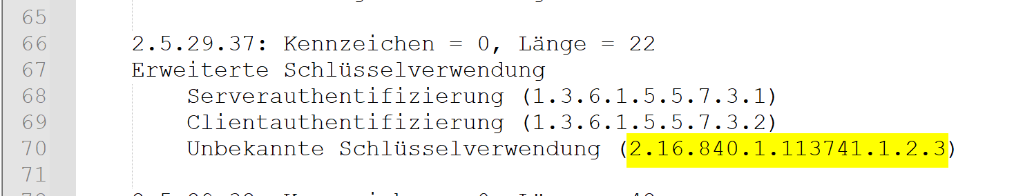

Certificate at the tenant, but still only "host based HBP" option, no option "TLS PKI" !?
PKI cert has the OID 2.16.840.1.113741.1.2.3 extension.
With HBP i get all laptops to this state, but all CCM only.
