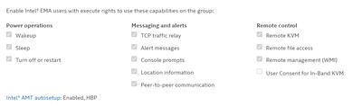

I am working on moving over to the new EMA. I have my first device provisioned and am trying to figure out how to power on the device on OOB. I do not see any option in actions.

I tried to follow the steps but I can't get into the MEBx because the provisioning set a random password and there is no way to get the password from the web portal. So I re-provisioned the MEBx with a profile that has a static password but that didn't seem to do anything as that password does not work either. I also ran the EMAAgent.exe with fulluninstall but that did not clear the password either so maybe I'm just outta luck.
I noticed in the endpoint group settings there isn't even an option for 'Power on'. Does IntelEMA even have the ability to turn on a computer that is off?
Also to answer the second question, yes, the PC was off.

Thank you for the copy\paste from the documentation but as you can see there is no 'power on' function. I do not need to put a PC to sleep or hibernate or power off or restart. My account is a tenant administrator and as you can see from the image posted earlier the endpoint group has all capabilities selected. However there is no power on option. Powering on PCs from an off state is the single function that I must have. Maybe Intel EMA does not have this function? If so I will need to stick with Intel SCS until this is fixed.

By any chance have you tried the "wake" option with the system been powered off? The Wake option (actually wake on LAN) is supposed to be the equivalent to Power On
Jose A.
THoob
3,981 Views
I tried the wake option and it worked on both a CIRA connected and non-connected PC.
My only concern now is if this an actual Wake-on-LAN broadcast then this may not work across subnets.
I do not believe our routers are setup to rebroadcast the packets.
I will get one of the devices moved outside my subnet and test again.

EMA can work on different LAN/WAN. There is a setting in the EMA server console and some ports need to be opened in the router, but it does wake the system.

I have tried the CIRA connected device in a different VLAN and it works.
For now I think this is good but I'm sure I will have many more questions.
