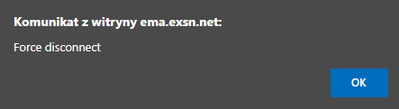

Hi, i have some problem with Intel Ema Agent in some computers, after connect the agent crashes, with dll error. I have this problem with some laptops so it isn't Windows problem ihmo.
Someone meet this problem?

Hi, thanks for reply.
1. I have specific error in webbrowser while connect to device with EMA Agent. This error screenshot as attach here, in the same time if this error apear the connection with EMA Agent was disconnected.
2. Provisioned with CIRA.
3. Ill attach event viewer here with 3 events connected with error. I must add this as txt becouse *.evtx is not acceptable.

We have reviewed the information provided, and we thank you for that. We have additional questions that will help us address the problem you are currently experiencing.
1. On how many devices are the the application crash events occurring?
2. How often are the application crash events? how many times a day/hour?
3. What OS language is installed on EMA Server and EMA clients?
In addition, please provide us with details of the AMT profile configurations.

1. At this moment every device is I install.
2. Not regularry but, after connection for 10-120s.
3. both ENG
Is there any options to expert AMT config via XML for example?

Please try the following troubleshooting:
  • Create a new Endpoint Group
  • Unprovision AMT on a problem endpoint and move it into the new group
  • Are there still application crashes when AMT is not provisioned?
  • Create a new AMT profile similar to your existing profile and disable the Web-based user interface option.
  • Apply the new AMT profile to the new Endpoint Group
  • Check if the crashes are still occurring
It is important to mention that currently there is not a method to copy or export the EMA AMT profile to an XML file.
