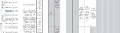

SKubo
3,163 Views
Hello Suneesh,
I have attached a picture of the wireless card.
SKubo
Suneesh
3,146 Views
Hello Satoshi,
Greetings of the day.
Thank you for sharing the card details.
We found a Fujitsu manual that indicates it uses Intel's standard manageability. Please verify the hardware manageability capabilities of the endpoints and provide us with a screenshot showing whether they support Full AMT or Standard Manageability. You can review the manual on the Fujitsu website: [Fujitsu System Catalog] (https://jp.fujitsu.com/platform/pc/product/catalog_syskou/syskou/bib/bib2312.pdf).
If the manageability is indeed standard manageability, then it may not support wireless.
Suneesh
SKubo
3,124 Views
Hello Suneesh,
Sorry, I'm not sure what information you want to know, but would the following information be okay?
It says Wireless (Intel vPro® Enterprise platform compatible), but is this actually compatible?
The endpoint product name, model number, and serial number are as follows.
・Product name: LIFEBOOK U9313/N
・Model name: FMVU66061
・SN: R4600447
SKubo
