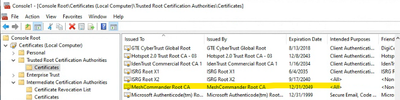

Getting back to the original issue of IMC displaying an error when connecting using TLS...
Initially was attempting to connect with AMT configured using the embedded self-signed TLS certificate, which, as noted above, is not supported by IMC.
To use TLS to connect to an AMT client using IMC, the following must be in place...
- The hostname must be set to a FQDN, IP address cannot be used
- Use TLS enabled
- A certificate must be installed on the AMT device with the Subject CN set to match the FQDN of the device
* Screenshot of certificate in Windows
* Screenshot showing above certificate installed an AMT device
- The root CA certificate (issuer certificate) must be installed in the Trusted Root Certificate store on the Windows computer where IMC is running. This enables IMC to trust the certificate installed on the AMT device
* Screenshot showing the certificate is indeed trusted on the Windows computer where IMC is running
- IMC v2.4 supports TLS 1.1 and newer, it does not support TLS 1.0. TLS 1.1 was implemented in AMT 11.6 so the connection must be to a computer running this version of AMT firmware or newer.
All of the above is in place however I still receive the same connection error.

This is not a self-signed certificate though. I created it using MeshCommander's built-in certificate authority. It is signed by a root CA certificate, also created in MeshCommander, that is trusted on the Windows system that IMC is running on.
There is a valid chain of trust so it should work.
As far as Intel AMT specific certificates, it's my understanding that those are needed only for initial provisioning when the AMT client is reaching out to the Setup and Configuration Application (SCA). That type of certificate must be installed on the SCA device, for example, when using Endpoint Management Assistant server.
I can't find any documentation stating that creating TLS connections to a client require a special certificate. Per the IMC documentation, the only requirement mentioned regarding certificates is that a certificate must be trusted on the Windows computer.
