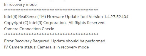

I can not install DCM. Firmware update fails with code -4. The problem has been described several time and apparently has no solution. Can I buy a module and replace it myself? For example https://ru.aliexpress.com/item/Intel-3D-RealSense-F200-Web-Camera-Module/32800823462.html Intel RealSense 3D F200 Веб Камера Модуль купить на AliExpress

For the information of other readers of this forum, Error code -4 - which is a rarely occurring error - is:
"The installer failed to update the firmware of your Intel RealSense 3D Camera. The camera firmware may be corrupted. Contact your computer manufacturer for recovery instructions. Error code: -4"
Attempts to try to update the firmware can result in the error message "The camera is in recovery mode". Example:
I have never encountered a case where a camera have been successfully restored from Recovery Mode, and my research indicates that Intel support staff members in the past have not been able to solve it either. So it would appear to be a candidate for replacement. Given that the F200 has not been on sale for a long time, it would be outside of the warranty return period, hence your request for how to order a replacement part.

The link was broken for me yesterday but is working now. If the firmware is stored on the main camera board then logic says that replacing the board with another one should restore access to the firmware.
Although I have never seen such a board transplant done myself, as the connector parts (marked with a '7' on the image in the link' can be purchased separately, you should theoretically be able to detach those parts from the board of your old F200 and connect them onto the new board so that you can attach the USB cable.

- Trying to force the F200 firmware to update on your current camera.
To make it a forced update, put the word -force at the end of the filename. For example:
FWUpdateF200.exe -force
