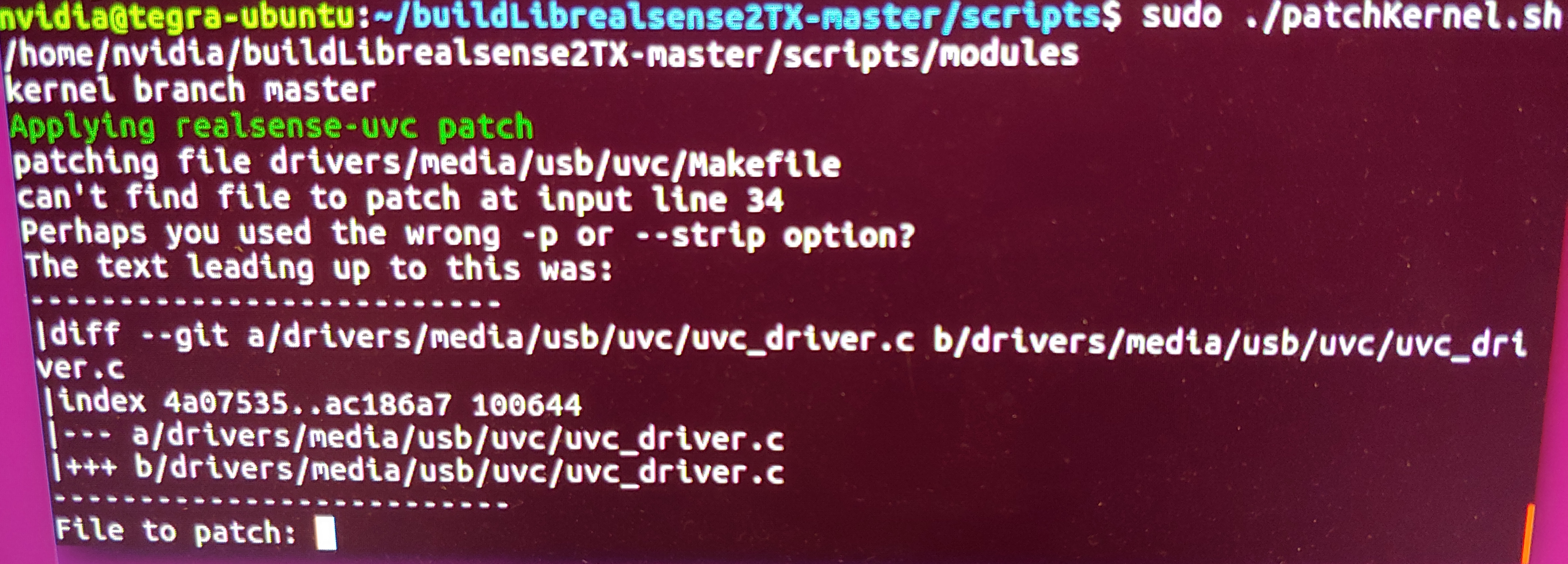

I have been trying to install the intel d435 sdk on the jetson tx1. Following the linux instructions for the package install does not work because of the jetson's arm processor. I flashed the jetson to the latest version of the L4T package, tried using this https://github.com/jetsonhacks/installLibrealsenseTX1 GitHub - jetsonhacks/installLibrealsenseTX1: Install lbrealsense for Intel RealSense cameras on Jetson TX1 Development K… , and https://github.com/jetsonhacks/buildLibrealsense2TX GitHub - jetsonhacks/buildLibrealsense2TX: Build librealsense 2.0 library on the NVIDIA Jetson TX Development kit. Intel… , but nothing has worked so far. The jetsonhacks installers seem to be looking for files that do not exist.

Thank you, but we are getting this message from the patch script.

My knowledge of Linux, and Jetson setup with Librealsense, is limited, unfortunately. The best thing to do may be to post a comment on the currently active RealSense GitHub discussion that I linked to above.
Can you tell me please if you followed Dorodnic's advice in that discussion: "As with every other non-Intel non-LTS Linux distro, you have a "backup" backend that does not rely on patching the kernel. To enable it, add -DFORCE_LIBUVC=true to CMake".
