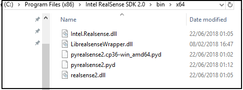

In the RealSense SDK 2.0 folder, there is a folder called 'bin' that contains pre-built versions of files so that the SDK can be run in Windows without needing to compile the SDK in Visual Studio. Pre-built realsense2.dll and Intel.RealSense.dll files are located here, at the following location:
Intel RealSense SDK 2. > bin > x64
Drag-and-drop realsense2.dll and Intel.RealSense.dll from this SDK folder into a folder called Plugins in your Unity project.

Hi Marty! Yes it worked!
I suggest to add this info into the readme of the SDK...
Thank you!
