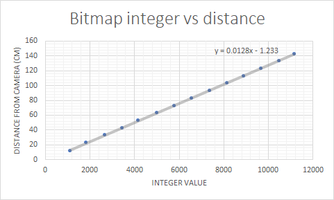

The framerate won't be the problem. I probably need to do operations on no more than 10 images. I would like to use the real (non-normalized) depth in the images. I read in the specifications that the SR300 has a range of 20 – 120cm. Does this mean 20cm is (0,0,0) and 12cm is (255,255,255)?

Yes, something like that would work - or once you have all the depth values you can find the Max and Min and use those?

This worked out well. I did some measurements, and now have a fine mapping between distance and bit value:
Thank you for your help so far. I've found that the average of the depth result is quite good, but there's, understandably, quite some deviation between samples. Do you know of a built-in solution to average over 10 samples? Right now I'm trying to convert them to WriteableBitmaps first, but this seems inefficient.
