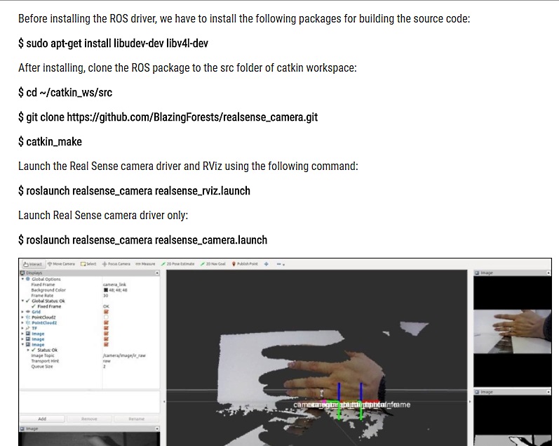

Rviz is a topic that is largely outside of my knowledge. You may find some useful insight in this document though that discusses its use with RealSense.
http://apprize.info/programming/ros/9.html Programming Vision Sensors using ROS, Open-CV, and PCL - Mastering ROS for Robotics Programming (2015)
It is formatted as one long web page, so to find the RealSense section with the Rviz info quickly, do a page find for the world 'realsense'.
Here's an image grab from the RealSense section for your easy reference
