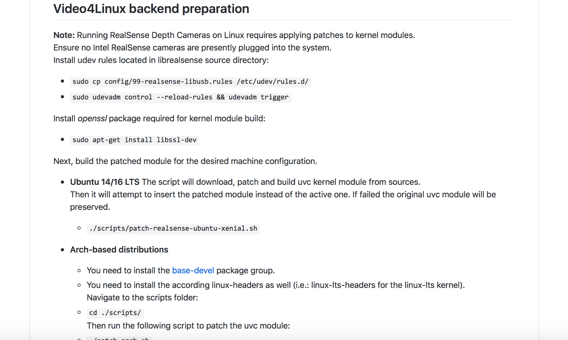

Hi MartyG,
Do you know the patch script of SR300? How to re-run the script? Because I think why the method you told me failed may because I did not do it in the right way.
And in fact, I do the re-running work based on the instruction on Github as shown in the attached screenshot, then run "sudo modprobe uvcvideo".
Am I do right?
By the way, the camera can still capture depth image and only cannot work on RGB image.
I have not performed the patching process myself because I am a Windows user. So the instructions that you linked to describe the patching process better than I can. It seems like the instructions that you should enter to do patching should be followed in this strict order:
sudo cp config/99-realsense-libusb.rules /etc/udev/rules.d/
sudo udevadm control --reload-rules && udevadm trigger
sudo apt-get install libssl-dev
The final step is to build the patched module. This is done on Ubuntu using the script below. Ignore the bit of the instructions that says ' Arch-based distributions', as that is for Arch Linux users and not Ubuntu.
./scripts/patch-realsense-ubuntu-xenial.sh
Once the script has been run, you can use the instruction below to check the logs to see if a new uvcvideo driver has been registered.
sudo dmesg | tail -n 50
