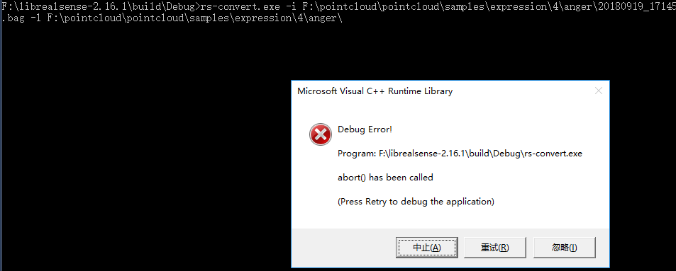

Hello MartyG,
when I run the rs-convert.exe .there has an error,
the rs-convert.exe was build from version 2.16.1,but I don't know how to solve it.
I haven't encountered this particular error with the convert tool, but there was a previous case where there was problems with it. This related to the path instructions provided to the program.
Looking at your image, I would recommend trying one conversion at a time, instead of both -i and -l. For example, to convert the bag to ply:
rs-convert.exe -l F:\pointcloud\pointcloud\samples\expression\4\anger
Hello MartyG,
I installed SDK version 2.16.1, and I use the version 2.16.1 source code to build rs-convert.exe, but the same error was showed as above, I want to know Rosbag fixes were added in RealSense SDK version 2.16.1.,Do I need to rebuild rs-convert.exe to obtain full frames by version 2.16.1 source code ?
As the rs-convert tool's source code is separate from the SDK package, you likely do not have to recompile it when upgrading SDK version.
In other words, the problem of missing frames has been solved in new SDK, we don't need to recompile re-convert to convert the .bag files.
I suggest giving it a try and letting us know what the results are in 2.16.1. Thanks!
